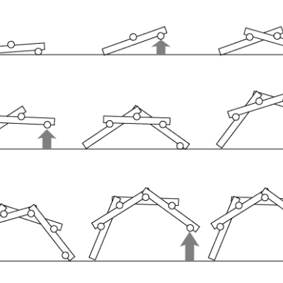

After talking with my contractor we've stepped away from the pre-built truss idea.
Preliminary plan is to re-use the existing roof joists as the bottom chord, raise the beam so that the top of it is level with the top of the joists and then stick frame in the rafters with collar ties.
Currently the beams rest on top of the beam. Doing it this way I would have about 3 1/2" of beam poking through the drywall.
Something like this.
