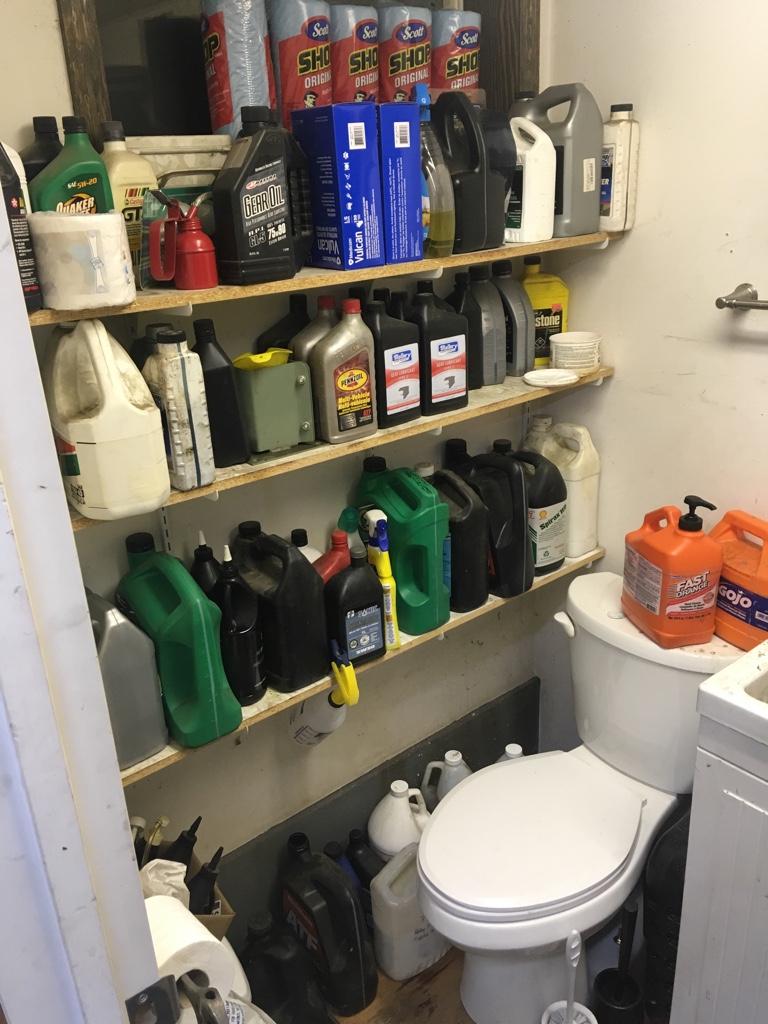

Nice! Do you have a mill in your washroom or a toilet in your shop LOL.
Toilet and hot water in shop. Toilet is also the oil storage room.
