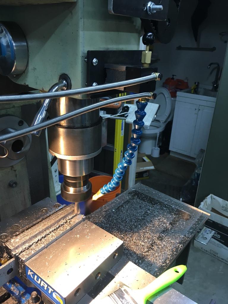

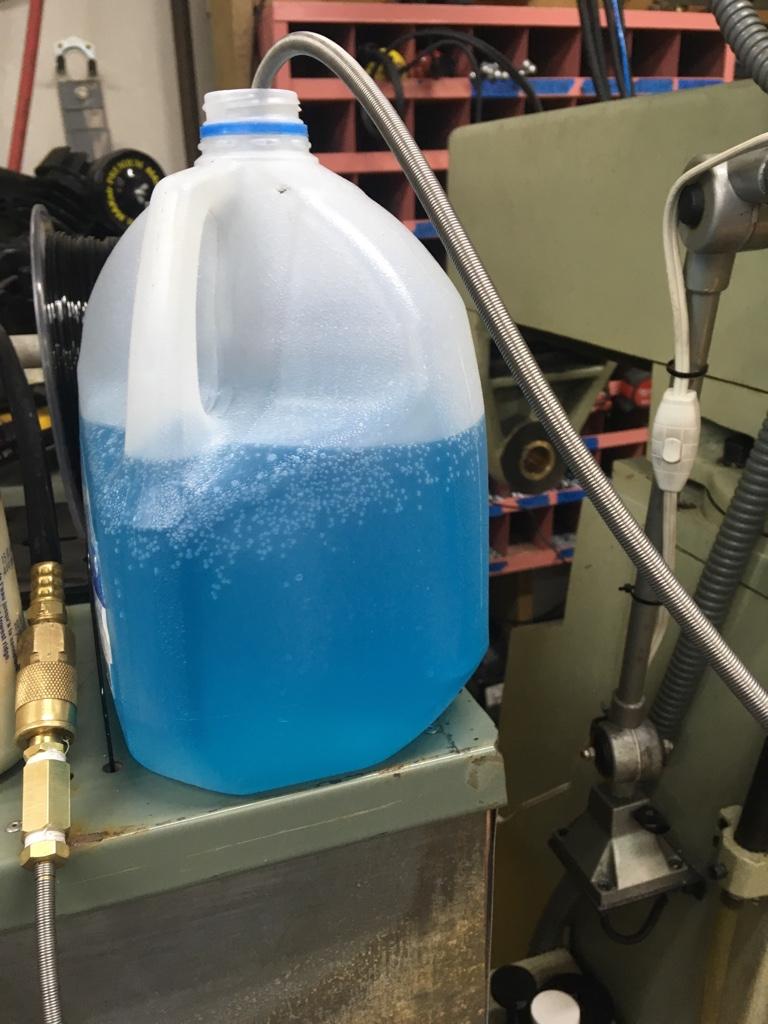

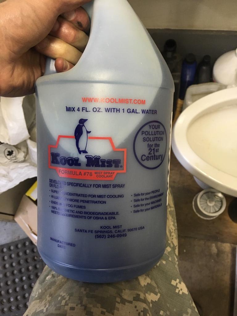

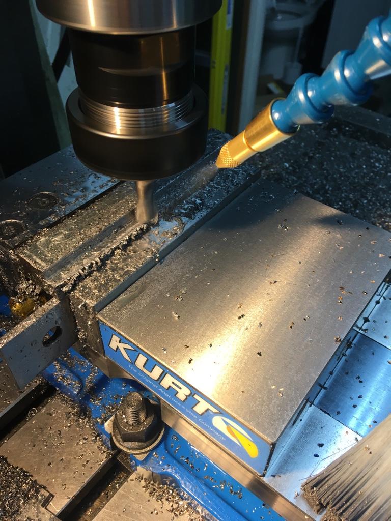

NOGA mister installed today, works good, makes a mess though but I can deal with that
