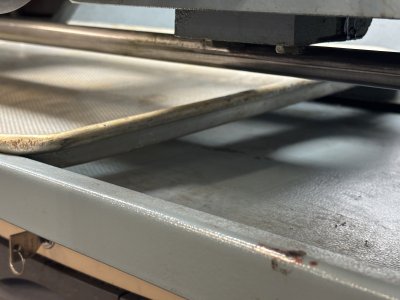

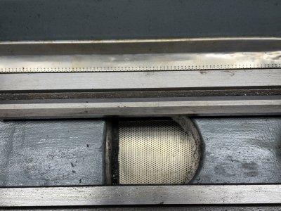

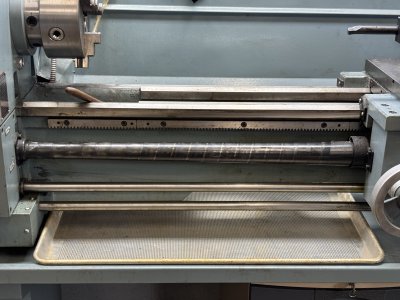

Hey guys it’s been a bit…haven’t been doing a lot of machining lately. I grabbed a commercial perforated baking sheet today. It’s 18”x 26” (18x32 would have been perfect) It fits in nicely and leaves a 1” or so gap to the bed for the coolant to drain out. It easily slides so if I ever need that extra few inches. Makes for easy clean up of chips and was only a whole 5 bucks lol.

If you have a choice in tray I would not go perforated. Its just asking for swarf to stick into (hard to brush out & ouchy on the hands). And fluid drippings to leak out. You can also get plastic cafeteria style trays pretty cheap at some of the discount sellers. That's what I'm using & they are very tough. We have a place called Wholesale Foods where you can source that kind of stuff. I also get other shop goodies like plastic sauce / condiment / take home? plastic containers (great for holding washing small parts), paper cups (mixing paint, epoxy whatever) stir sticks... And well stuff for the kitchen too, of course LOL

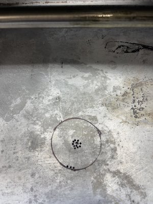

Thanks lol. I just found out the holes aren’t the way to go. I was glad I grabbed one of each. I marked where my drip pan hole is and add a dozen little small holes and dimple the tray there to let any coolant out. Anytime there’s anything in it. I’ll just let it drip out for the night and dump it the next day.
