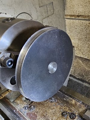

Time to work on my 360 degree dial for my compound.

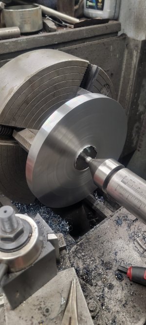

I threaded the plate for a fine thread 1.5" stub arbour. Then had at it.

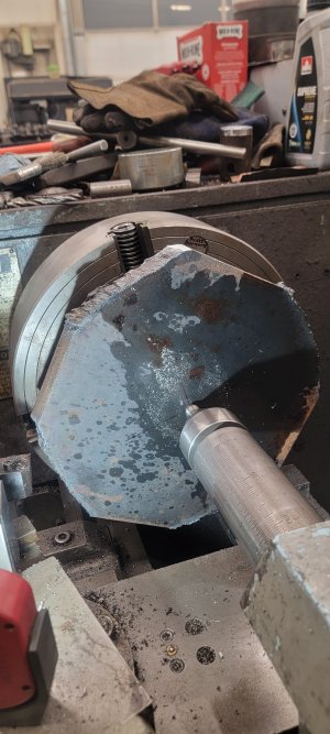

Took almost 2 days to trepan this 1/2" plate to make the collet to hold the dial. I could only cut a thou at a crack cuz the thing chattered like an old lady! My autofeed doesn't go that shallow so I had to feed it manually just skirting the chatter.
I know, I should have just torched the ears off.

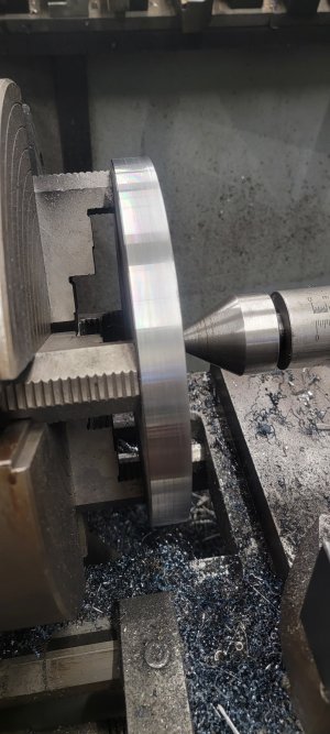

Here it is ready for turning.
And here it is turned down with just enough to make collet ears to hold the degree disk.
Next, I'll remove most of the center, with flats to hold the degree disk concentric and flat, and then cut 8 slits in the disk to make flexible collet ears. Each jaw of my 4 jaw chuck will close two collet ears onto the degree disk. I might test it with 4 collet ears each centered on a jaw first.
Got a bit more done last night.
The outside rim of the collet is tapered so the chuck jaws will cause the collet to close as the Jaws tighten.
The part will sit mainly on the outer landing so it sits flat. It should sit on the inner landing too until the collet is closed. I'll take the whole arbour down to the landing height as I get close, but need it for rigidity for now.
Lots of chatter because the part is thin. I'll switch to a hand sharpened HSS tool to clean up the chatter at the same time as I close in on final dimensions.
@Darren's approach would have much less chatter by design. Mine is a bell that likes to sing.
