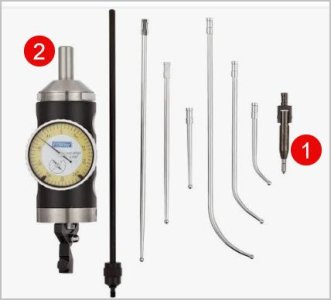

I thought he meant holding the COAX in the tailstock and letting the probe touch a center or something in the headstock while the headstock rotates. I would think that would negate gravity, but I want to test it.
1) a centering tip is included in the kit
2) but to indicate, the driveshaft has to be rotating & the body held in position with the side rod, so not sure how that would occur being held in TS?
Ah yes. Stupidity sometimes arrives in giant buckets. I was so focussed on defeating gravity that I also inverted the whole concept. I have no idea how that brain fart happened and no explanation either.
As I read your comment I see myself setting up my little gravity experiment and then suddenly realizing how stupid the whole thought was.
Thank you for saving me that grief...
