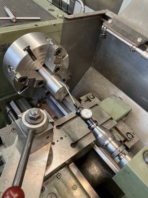

2) but to indicate, the driveshaft has to be rotating & the body held in position with the side rod, so not sure how that would occur being held in TS?
I’m not sure I follow the comment. Granted I usually use some sort of mag base dial indicator for dialing in a part in a 4J on the lathe - several options to choose from, depending on obstacles / access. The co-ax is just another indicator.
Attached here is what I was trying to describe, the drive shaft is stationary in the tailstock chuck, the part held by the headstock (4J) is what is rotating. Works great.

That said, I don't see the point of using a coax indicator if the COAX part isn't turning. Any indicator would do. I'd have realized that myself if I had only thought about it a bit instead of getting sucked into @PeterT's gravity well. If it were not so relevant, it might be better to just call it the proverbial overweight rabbit hole.
But ya, if you don't own any other indicators with long rods, it could be used that way.
