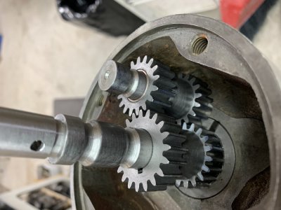

Great day making gears today. Spent yesterday making blanks and cursing the failed broach fiasco and then came today!!!
cutting gears to replace the missing parts in my tool grinder. The slow feed in my model was supposed to have helical gears - hard to make, so I made spur gears as would have been the way of the 1930’s models. Since they didn’t change the casting for the handle I could revert to the old gearing.

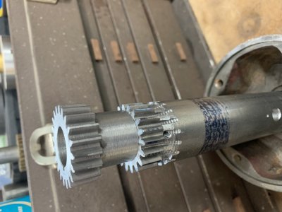

I made a new stationary gear shaft from 1-1/2” 4140 with bushing pressed into either end to support a 3/4” shaft that drives a bronze gear. This gear moves the rack back an forth while grinding. This shaft received 19 gear teeth. 14DP - 14.5° PA.

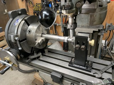

Then I machined the broached blank with 20 Teeth - all same cutter so set up was quick and easy.
I then cut the spool with 18 Teeth on one end and 17 teeth the other.

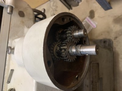

Then we had some assembly time:
The smaller gears are Cast Iron.

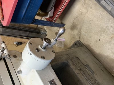

I lubbed up everything with some assembly grease and put it on the machine.
Works like a charm!!
You push in the centre shaft to engage the slow gear and it rotates on the bigger shaft to reduce the feed speed - I forget the amount sorta 4-1 type thing.

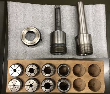

I am looking for any Oz40 collets or Weldon adaptor sleeves if anyone has any of those out there?
If things go well I may be doing some sharpening sooner than later - just need to get home....
@RobinHood - that would be great. I have 1/4” and I think 3/4” for the sharpening head. I have been looking for a few more and then I can start doing some sharpening. My Weldon sharpening jig will be getting some tune up as well - that would be the helical part of the sharpener :)
So I checked. They are OZ25s made in Germany, not the 40s you are looking for. I also have a MT3 & a MT4 collet holder for them. Not sure if that would help you any.
Hmmm... are the holders threaded for a draw bar? What size are the collets? I might be interested.
The MT3 holder (top left) only has a tang. The MT4 uses a 5/8-11 thread. There is only one nut for both holders and no key.
The collet sizes are: 1/8, 1/4, 5/16, 1/2, 5/8, 3/4, 7/8 and 1”. They are Made in Germany by Ortlieb, sold by KAR here in Canada.
@RobinHood :I will PM you on the units. I have a 50 taper To MT4 and MT3 that fits the head of the main grinder holder. Your selection should be good for any end mills I have as well I have the fill in sizes of oz 25
