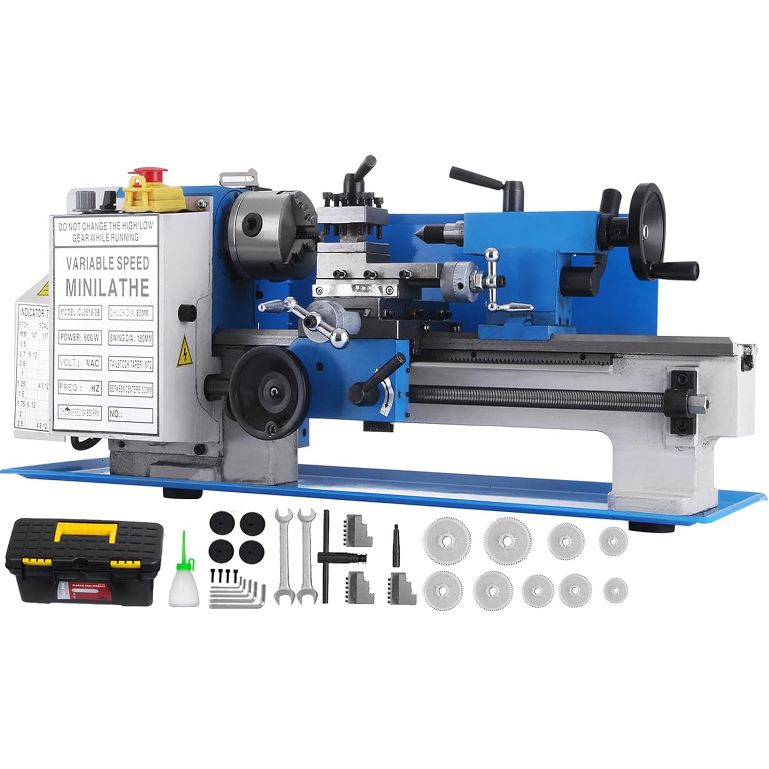

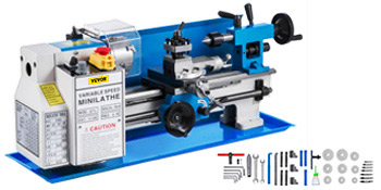

I admit, I got REALLY excited for a moment because the main image on that page shows the lathe with a bunch of useful accessories - like an extra 4-jaw chuck, a steady rest, a quick-change tool holder, etc... with that stuff the price would be insanely good... but you have to match up the lathe options with the "Package Content" in the description section. It seems like the main image is just a placeholder for all the lathes on the product listing page.
The 7x12 550w - US version comes with:
  • 1 x Mini Metal Lathe
  • 1 x Lamp
  • 1 x Oil Can
  • 3 x Chuck Jaw
  • 9 x Gear
  • 5 x Allen Key
  • 2 x Wrench
  • 1 x Set of Fitting
  • 1 x Manual
