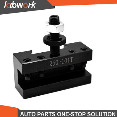

There are 250-101T (XL) AXA holders which will take up to 3/4 tools.@Susquatch You said you got this set from Amazon: https://a.co/d/8g8MUfG
I learned on HSS and have bucketloads of it, but want to start using/learning inserts. I like the idea of a set like this that lets me try a few different shapes, but I have an AXA QCTP, and it looks like it won't quite fit that 5/8" shank insert holder. The 1/2 in. sets look less interesting and have less descriptive info in their ads. I thought about getting the set you mentioned and milling down the shank to fit my QCTP, but the fine print suggests that it may be hardened, so that I can't to do that. Andy thoughts on that, or other suggestions?
Thanks for that info - my 250-101 (I think it is) measures about 9/16 at most, but if the one you link to has a larger slot, or if I can mill down a 5/8 shank to fit what I have that's two possible solutions. Since I can use another tool holder or two anyway I should see if I can find a reasonably priced Canadian source for those. I suppose I could also mill out a tool holder by 1/16th or so, rather than mill down the tool shank. At the moment all my milling tools are also HSS, so there will be some limit to what hardness I can mill.There are 250-101T (XL) AXA holders which will take up to 3/4 tools.
Labwork AXA #1 250-101 XL Turning Tool Holder Quick Change For 6-12" Lathe | eBay
<li> Fitment:</li> <li>For Use With Lathe Swing 6-12" Piston Type Or Wedge Type Tool Posts Sets</li> <li> </li> <li>Description:</li> <li>-Brand New -Use Tool Bit 3/16"to 5/8" -Hex Key Size: 1/8" -Set Screw Thread Size: M8x19 -Height Adjustment Screw Allows To Accommodate Various Center Height...www.ebay.com
I've milled a lot of import tool shanks. They are hard, but not that hard.
I've tooled my lathe completely with tools like this set. They've all been good quality, no junk.
The positive rake inserts like TCMT, CCMT are well suited to small lathes.
