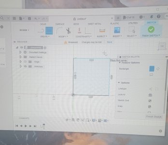

I got most of the way there. Here is what I did:
I clicked create sketch.
Then selected the xy plane
Then clicked 2 point rectangle
Clicked on origin
Then moved the mouse to 2,2 and clicked again.
Then clicked on the house (home) view in 5he top right corner.
Then clicked on my rectangle.
Where is extrude?
Start with the XY plane as the drawing surface. Then select the draw rectangle anchored on the center instead of corner. Drop it on the origin of the sketch and then tab between fields to set the dimension. Hit ENTER to save. Then as David said, extrude to a height in either the positive or negative direction.

That did result in a 2D plane. But where is draw rectangle?
I think some screen shots of the "create sketch" button and selecting the plane etc may be in order.

I can't get to the more advanced examples you guys are making me drool over until I get a 3D block on my screen. It's that initial hurdle of getting the block that I'm missing.

Are you doing this in Alibre ATOM or in Fusion360? Post a full screen shot.
If you are using Alibre ATOM @David_R8 can post his screen to show you what he's doing. I have the full Alibre and have dragged my tool bars to the RHS. Yours might not be enabled to be visible. Look at post #26 in this thread and you will see beside the edit icon the extrude and below that the cut icons in the furthest to the right column of icons.

Ah Fusion. It has modes which can be confusing. When you create a sketch to do 2D stuff then you have hit the 'Finish Sketch' button to get out of that mode. Then you can click the extrude - select the face to extrude (your rectangle) and extrude to the height you want.
John try my mini tutorial: (and anyone else who is interested)
Getting Started with Fusion 360
I explain a few of the gotcha's and work flow things. Stuff Lars has forgotten it is so basic for him.
