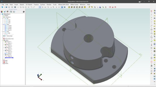

BTW, I know Alibre Design changed their User Interface away from the one I'm comfortable with when they released Revision 26 which is the revision of Alibre Atom that @David_R8 is using. Suddenly the ICONs along the top are larger and you can't make them smaller so they take up more of the drawing screen. Not a lot but annoying. And the owner of Alibre 'claims' it couldn't be helped. I don't believe him. But I think he's trying to make Alibre more Fusion360 like in the user interface.
What the two screen shots show is his 'changes' have impacted the amount of usable space for the drawing and the top menu bar is now forced to that stupid dark background with white text which my old eyes have more trouble reading. Again. It's not a lot but enough that if I wanted more on the upper tool bar I'd have to have two lines and lose even more area.

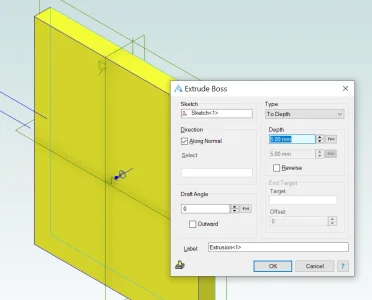

Use the rectangle tool to draw the square. It will/should allow you to enter the dimensions for the sides.
Switch back to 3D and extrude the square.
Presto a lovely 2" x2" x 5" block of 12L14 :D

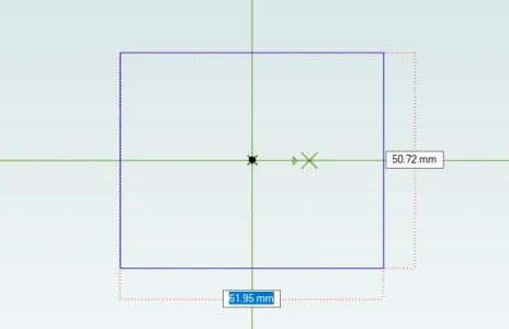

Start with the XY plane as the drawing surface. Then select the draw rectangle anchored on the center instead of corner. Drop it on the origin of the sketch and then tab between fields to set the dimension. Hit ENTER to save. Then as David said, extrude to a height in either the positive or negative direction.

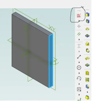

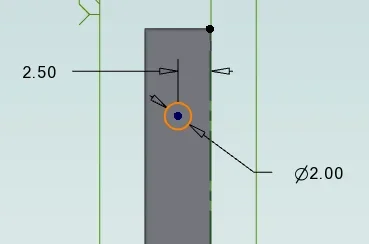

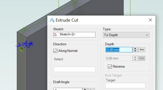

Now let's put a screw hole in the side.

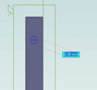

Select the side and click on the 2D draw ICON I have circled on the side. Or however you have your user interface set up.
Draw a circle on the side which has now been presented as a flat 2D surface and set the diameter to 2.0mm
Then select extrude cut and drill the hole.
And so on.

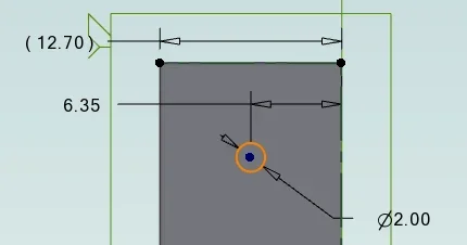

Oops. Forgot to position the hole in the center of the edge.
Not a problem. Select Sketch<2> (which you can rename to be end mount hole if you want). Right click on that and you are again presented with the drawing surface.
Now we could just select the dimension tool and the center of the hole and the edge. Then enter in what we know is 2.5mm for the centerline of our 5mm thick part.

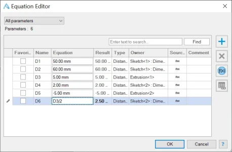

That's the easy way but this is what they call parametric CAD. There's a more fun way to do this. I can click on the f(x) button instead and get this dialog. There are ways to rename and make this more human friendly but for now we know that we extruded the first part to be 5mm thick so we use half of that to position the hole from the side.
The hole is still 2.5mm from the edge.

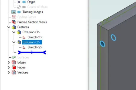

But now thinking about it I really want this piece to be 1/2" thick because that's a piece I have lying around. I'm working in metric units right?
Right click on the original thickness extrusion.
And enter the 0.5" with the double quote signifying inches instead of the default mm.
Save and edit the 2D Sketch again and see how the hole stays in the middle and our part to which I added a dimension so I can see the width (but can't change it here) now has the hole still centered.
I could have not used the function and always have it 2.5mm from one side.
