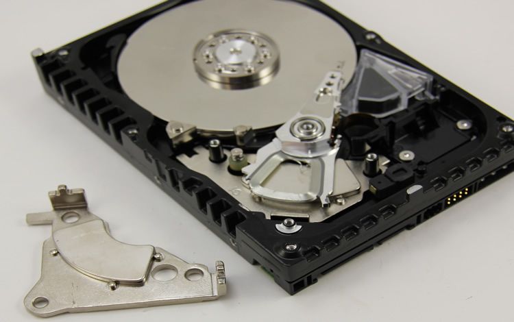

suggestion: go find some dead computer hard drives. Killer magnets, usually flat, semi-circular poles, with backing plates and mounting holes. I use them all over my shop. Goofiest application I have: the tail stock quill on the Busy Bee B2227 lathe retracts completely into the barrel, so there’s no way to attach a dial indicator. Big hard drive magnet, aluminum bar bolted to the magnet, magnet stuck to the quill, dial indicator plunger against the magnet. (yes, the plunger is crooked, I just set it up quickly to take the photos)

I bet they can be had at any computer store as broken scrap.
But you can also buy neobium magnets in bulk on amazon in different sizes and attachment styles.
