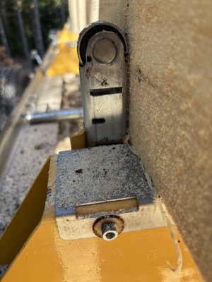

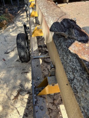

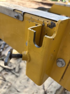

Anyone Milling lumber on a Frontier or similar sawmill? If so I made some log stop modifications that work amazing:

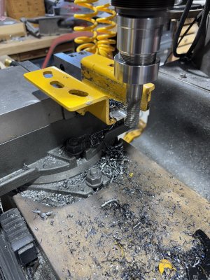

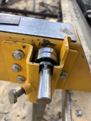

After that I machined the stops and added roller bearings to allow turning the logs much easier. The stops are 40mm x 40 mm and the bearings are 40 mm x 17 mm. I machined 17 mm pins to fit the bearings and they are 19 mm stainless. The slots are 20 mm.
I went a bit over the top and milled in gradients at 2 inch intervals and then added the 1 inch grads in between. Anyway so easy to grab the pin to adjust and they drop out of the way for final cuts.

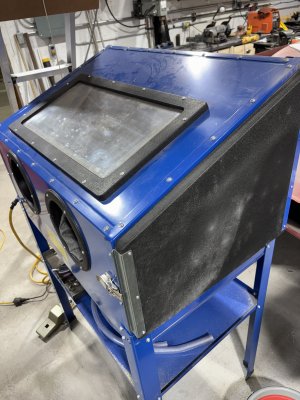

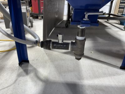

Anyone bought or considering a PA sand blast cabinet?

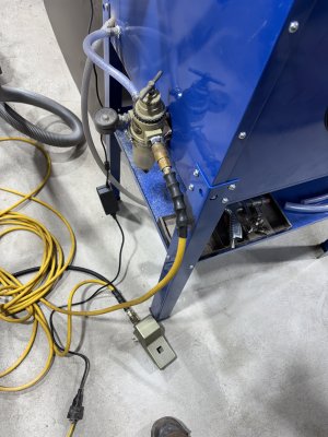

Got this on sale and immediately upgraded certain parts. Media suction tube gone and added the bottom mod. For me, I peeled back the foam in the bottom of the media door and welded in a 1” pipe flange (PA)
The media tube is about 5/8 OD. All the fittings are 1” pipe and you need a 1” reducer to a barbed hose connection.
I bought an online Chinese replacement blast gun and have modified it to work great. I also fixed the supplied trigger gun and it works well now too.
I added the foot peddle control for the gun and a water separator.
So the main issue with the “gun” the “function” of the system is how to match the blast system with your
Compressor output and the tools you have. I will add more tomorrow about my research and what I did to make this blast cabinet rock!!

I have that exact cabinet and am curious about your mods.

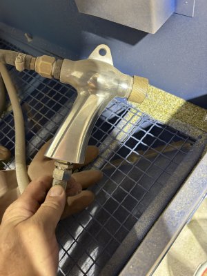

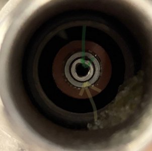

So, the gun that comes with the cabinet can work well, but may have some issues that need some attention. Compressor size with respect to CFM output at a decent pressure is also important.
The nozzle the gun uses and the orifice the air passes through are important as well. My compressor will put out about 12 cfm at 90 psi - not a huge amount but decent for lots of applications. The gun that comes with the cabinet has a 1/8” orifice. That is at the limit for my compressor. The Chinese gun I bought had a 5mm or 0.196” orifice. Needless to say when connected it didn’t work at all and just shot air. What happens is the orifice size allows for the media suction to be optimized at a lower CFM. I machined a plug about 0.197” and pressed it into the original orifice. Then I drilled a through hole at 3/32” (0.0937”). This matches more closely to my compressors output. With a vacuum gauge connected to the media input of the gun I was getting -8 in hg ! The blast beads flowed and the metal was cleaned in spectacular fashion!
The yellow arrow is the original orifice diameter and the green is the new reduced diameter.
My blaster gun now puts the 20/30 glass media through at 60 psi steady. The nozzle (the ceramic or boron or….) part of the gun is optimized at 2 x the diameter of the orifice. In my case a 5mm nozzle would be the best. The Chinese gun came with 6mm and it works ok.
For the original gun, it has a trigger and I found it clogged up a lot. After careful inspection I did some clean up. The orifice piece can be unscrewed (11mm). The port the blast media comes in had casting material still in it so I drilled that crap out after removing the orifice piece. Then I chamfered the inlet for a smoother passage. The orifice had some retaining compound build up in the passage for the media so I scrapped it out with an end mill (hard stuff) and that cleared the way for the blasting media. After re-assembly the gun worked fine but could do with re-machining orifice to the 3/32” size.

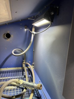

The light in my cabinet is an LED light bar for an ATV/SxS so it is all sealed. It is 12 volts so I power it with a 120/12 power supply from Princess Auto.

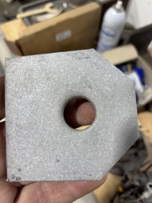

The results are awesome
That was maybe a minute and all the mill scale is gone!
There are a lot of videos on “upgrading” this type of cabinet but not many explain the gun and how it all goes together. One video had a fast explanation of the chart that matched gun orifice size to your compressor - that proved to be the TSN turning point for me and sorting out the gun/CFM issues.
I noted that one manufacturer offered the 3/32” orifice and made that size.

Thanks for the tip on the orifice size. I had done all the common mods to the same cabinet but nothing really made much of a difference. I was blaming the compressor, 6CFM@90psi, until I made the orifice smaller. I plugged it with a slug of brass and drilled it out to 3/32, my smallest drill size. Wasn't really expecting much of an improvement but it works like a dream now.
I still think more psi is going to be better because,..,,MORE IS BETTER!
Right?
but honestly, this was night and day difference for minimal effort.
And cost me nothing but a little time.
