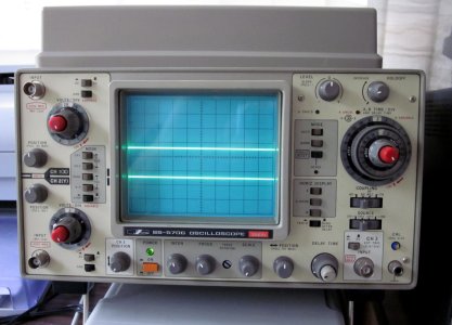

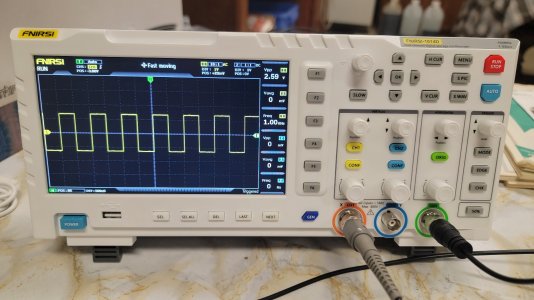

Settings suggestions? Let's assume I'm trying to catch a 7 Volt, 3 Hz square wave for about 180 RPM. About 2V/cm & 200 mS/cm?
I'd use the external trigger input, connect that to the same point as your regular input with an alligator clip, and try setting the sensitivity to auto. You shouldn't need a high frequency input nor trigger filtering for this job. I've been known to just push buttons too.... LOL!
When you speak of a small RC circuit are you speaking of a series resistor (value?) with a small (a few pf) cap between the signal side of the resistor and ground?
Given how low the frequency is, I was thinking two 50k resistors in series with the signal input to the device or the scope and a few microfarads in between them to ground. You will know when you see the signal whether that is too much or too little. I just want to get rid of the high frequency noise - if any. The resistor on the scope side isn't required, but it usually helps maintain a better signal too. You are just making what is frequently called a "low pass filter". You can find formulas on the web, but I usually just play with it till I see what I want.
