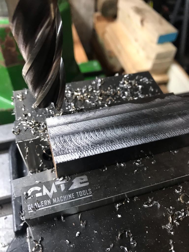

Are you making chips yet?
Sure am.
Just fooling around here.

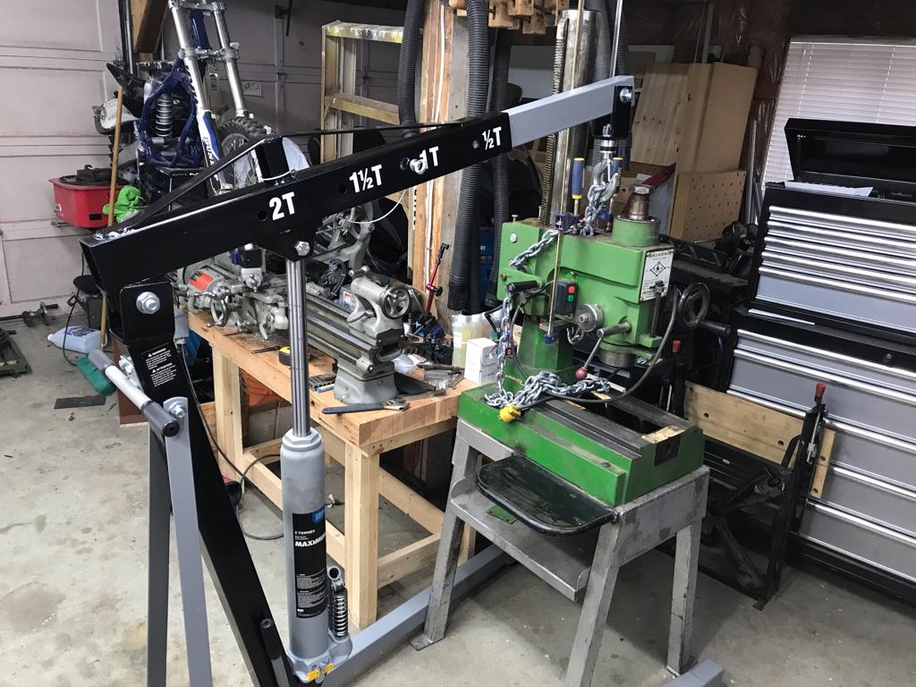

Hey David,
Could you please post an image of the entire machine as it sits on it's stand so that I can get a feel for it's size.
Maybe put a yard stick in the image if you have one.

Nice! No one got hurt and no damaged components, that's a win for sure. When I got my shaper I just borrowed a folding engine crane from my buddy's shop (ironically, I now work for that buddy a year later) and he was happy for just doughnuts in return. Depending on your connections, like a your local mechanic's shop, you might be able to horse trade some doughnuts and coffee for use of the crane for a day if they're not in the middle of an engine job. I agree with the others though, not worth wrecking one's back for stuff like this. We have hydraulics and leverage for a reason, lol!

Hey David,
Thanks,
Does this mean you bought that mill???
I’m standing in the line at Home Depot so here’s a teaser.
With the head raised to the top and the cover installed it would be about 7 feet tall.
This manual says it’s 43.5” tall. That sounds about right to me.
http://blog.penntoolco.com/munics_files/webshare/RF-30-manual.pdf
