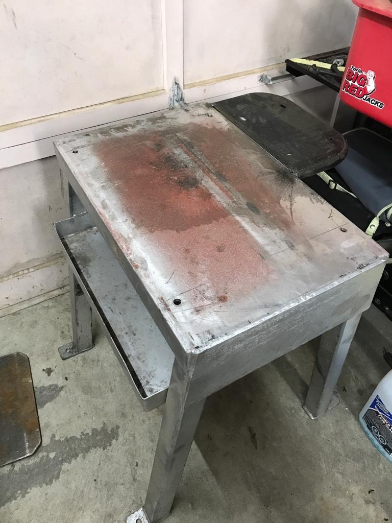

The mill came with this stand.
The photo is from the back of the stand.
The stand alone probably weighs 40 pounds!
