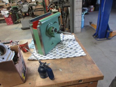

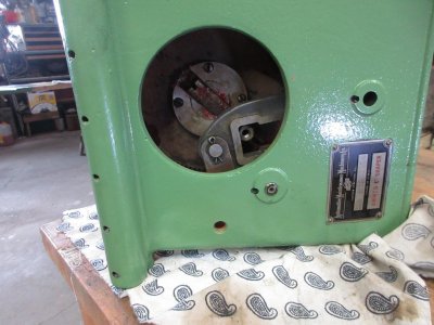

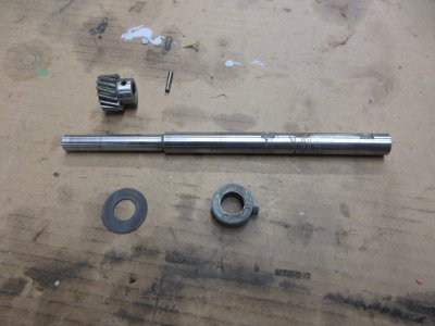

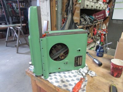

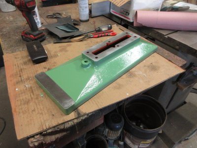

I removed all of the masking from the painted parts. Then ran a tap through all of the threaded holes on the castings. Afterward used compressed air to blow out all of the tapped holes and castings. I also cleaned all of the bearing surfaces as well. Assembly now starts I am using a bit of GP grease on the bearings for assembly. The main drive shaft and pinion have been cleaned but I suspect that this shaft has been replaced. I have a theory. More on this latter.
Now what is wrong in this picture?

Before you bolt too much together, I recommend verifying that the ways are parallel to the base. And perpendicular to the knee dovetail. Harder to do once it is assembled.
Not sure if you are thinking of uppping the HP from 1/3 to 1/2 or more, I would strongly recommend against that. The fiber main gear will not take that level of power.
I am going to use the 1/3 HP motor that has been supplied with the shaper for now. I wanted this machine for making internal keyways as I am limited with my milling machine. I never thought of checking how true the machine is. My TOS FN20 is very accurate and I normally use it should a part demand close tolerance to be met.

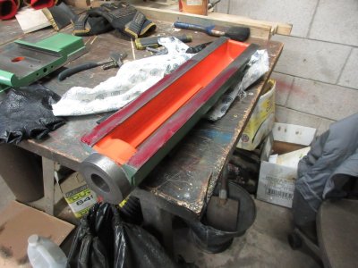

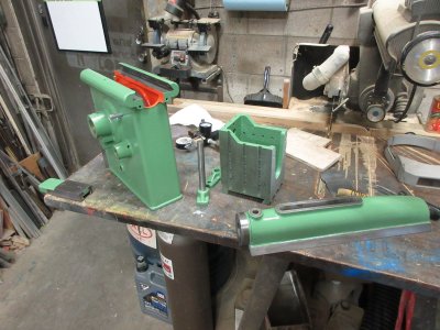

At this point of the restoration I made a template for the base before it was bolted to the body of the shaper. I am coming to a conclusion that the damage to the clapper box was not from a crash hitting the work, but rather the machine fell over as several parts that I have been cleaning have been brazed and fitted. The X screw is not original nor is the ratchet to drive the screw. I cannot find the table Z Axis screw. I kind of remember seeing it, but it too was kind of rigged affair so I bit the bullet so to speak and purchased a brass 5/8" x 11 pitch length of threaded rod from R.E Glover Hamilton. I asked for 12" but had to take 36", $122 CND that kind of hurt. I worked on cleaning the tool post slide, thread and handle as both were kind of rusty. No pitting but needed a buff with a rubber diamond wheel in my dremel. Some small parts that I forgot to take out when I was sandblasting and it is not worth setting up so I chemical stripped, sanded, primed and top coated these parts with a small brush. Pulleys and Oil Cups came in yesterday from China. The oil cups have metric threads, I will turn some threaded sleeves for each one on the shaper to be able to press fit into the existing oiling holes. The step pulleys are nice but do not have a set screw so I will be drilling an tapping each of the 2 step pulleys.

That shiny part of the base is for the skate. Shapers put a fair bit of stress on the box, so they have a sliding support .
