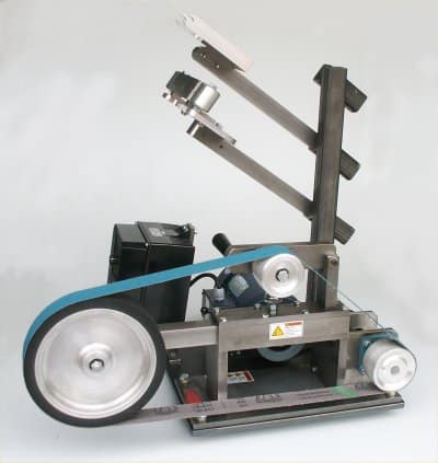

I've been eyeing this VRT shop 100% bolt together design. Of course there are some things I might do a bit different but I suspect all these grinders inevitably get a personal touch in some manner, or have to be modified on basis of motor selection, space limits, whatever. Of course if you have a welder there are lots of places where it would be beneficial, so use it. But I'm trying to visualize issues where a bolt together would not be satisfactory. Maybe my brain just wants to see if an IKEA 1-hex wrench design is possible haha.

The welded designs in my mind seem like a lot less work then a bolted only design. I can throw down some serious weld in the time it takes me to measure, align, drill and tap a whole bunch of bolt holes or threaded holes. I also have welders and can weld OK for an amateur.
The welding seems like such an easier option to me, if I hadn’t bought a mig welder, I would buy one for the project and sell when I’m done.
But there are definately people that are better at milling/drilling/layout then I am by miles.
In my mind though when I do the time spent calculation, the welded option is easy street. And the drilled/milled/bolted option is much more laborious. Could be wrong though.
It might just be what I am comfortable with.

I dunno, you guys tell me. Is $825 (cheapest option) no electrics, no belts, smallest tool rest... a good price for what you see?
I know a couple of guys who own these units and they are quite happy with them. IMHO, It seems like a pretty solid little grinder for the price.
@PeterT it is not a tilting design, so it’s simply a vertical grinder.
It’s also more money then I am spending on Jer Schmidt’s design that I am building right now, although it is a complete unit so no building involved.
It seems like a decent unit though, but for me, the tilting feature was a must have, as I have no desire to own two belt grinders, but think the horizontal mode would come in crazy handy, especially with a small wheel attachment.
