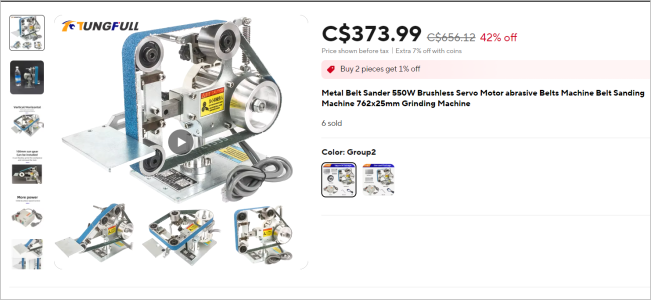

On the smaller scale, has anyone seen plans for a 1x32 (25x762mm) or Wx48" along the lines of these Chinese ones, but ideally given the Phil Vandelay touch? I've come to the conclusion a 2x72 is too much for my needs, at least my immediate needs. Those big boys have the power to hog steel like crazy, but I'm after something that is lower power, smaller footprint, but specifically for sharpening & dressing & light metalwork.

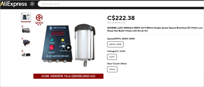

I've watched some YouTube videos of this one (or its clones). Despite the so-so quality, they actually look useful for my purposes. Belts are abundant including same size finishing & stropping. But I think I could do a better job producing components & fixtures from my own design if I had a head start from good plans. Its small enough to be made on my machines and/or a few select items jobbed out to local cutting service or PCB Way or whatever. But seems like the bigger 2x72 are 90% of the plans & kit market out there for whatever reason.

They look tempting but the 1" width is a non starter for me. The grinder belt attachments also look tempting at times too, but I already bought my metal stock for A 2X72

Sure, fire away. I don't want to swing the discussion to my own selfish needs but the post subject seemed kind of wide. I've seem some guys retrofitting (fixing) the Harbor Fright 1x42 & their clones. That's what makes me thing just scratch building one would be money better spent. Maybe people with more space & money just go straight to the 72" because a heavy machine can do everything a light machine can, but not the other way around. But the cost goes up proportionately - the frame is bigger as are the accessories, motor, VFD... I think the 30" might be on the small toy size vs a 42" but that's just eyeballing videos like these
Or maybe I should just 'miniaturize' a 2x72 set of plans & adjust what needs to be adjusted. I'm not sure if the hardware kits (pulleys mainly) are as common or accessible as 72" either.

The thing about cost though, if your going to build a 1” grinder with a stout frame and solid mechanical parts, you’ll probably spend 5-600$ when you are all said and done.
A 3/4hp or 1 hp motor is still 250$ new, and a vfd, even from Amazon is 100$.
Used you could cut that in half, maybe, but things add up super fast.
Unless you are going for a single speed single phase motor, then the build might cost you significantly less. Light switch to turn on and off and a 30$ marketplace motor…..
You’ll likely have to make your own wheels for the 1x grinder. A nice lathe project.

I probably agree with the cost/scale comments. My hope (maybe a fantasy) is a completely bolt together frame, maybe more aluminum based which would be even more rigid than the sheet metal fittings (on the 1x30). The intent would be to focus on better accuracy, more/better bearings, reduced running vibration, better fixtures, that kind of thing. On the motor front there are similar but slightly better Chinese motor/speed control packages that come in incremental sizes above the 550watt sewing machine setup on the 1x30. I just don't think general sharpening is going to tax that power level. My old Delta 1x42 will 'grind' to an extent that would obliterate any tool edge on only 1/3hp AC (I think) but its fixed RPM, non reversible, perpetually filled with ignitable sawdust...
Buy ya, there is a risk of dropping $500 on a cute toy & it becomes a part time sharpener because that's all its really capable of. I did see one video where a guy pushed a 10mm steel rod into the belt for a nice spark show. The motor bogged but nothing broke. Not that I think the machine is intended for that. This is why I still break out the Japanese water stones & sharpen my knives by hand & just go Zen (for a couple hours).

@PeterT i mean it would be a super cool project. And if you built it nice it would be a pretty sweet little unit.
The major costs of both the grinder sizes I think is the motor/VFD.
500$ is a lot for a 1x30 though, even if it is a sweet one.
I mean I might build one if you come up with plans just as a deadly little sharpener, only because I may stumble on a motor one day and I have a drive for a half horse on the shelf.
