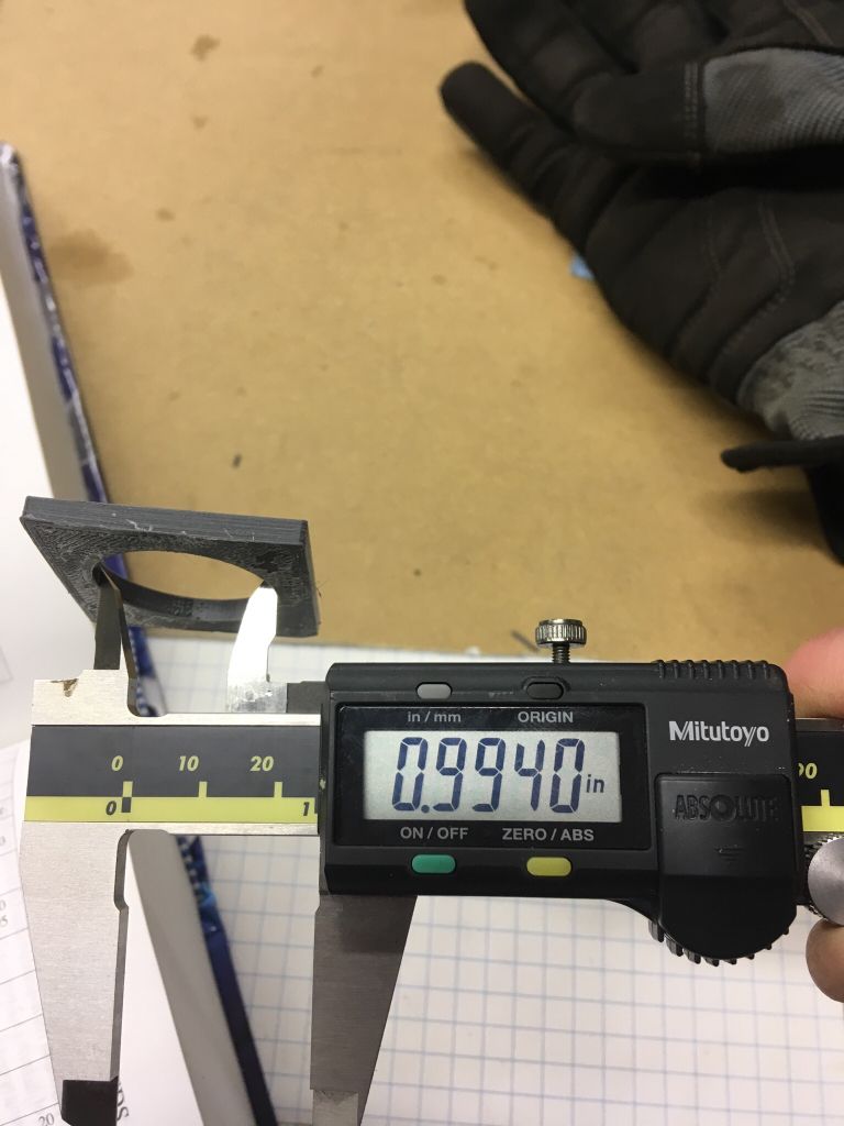

I cant offer anything useful (because I don't have a 3DP) other than to say I hear about this issue quite a bit in other forums where people are attempting to make things with a bit more dimensional precision. (And no, desk goblin figurines don't fall into this category HaHa). Some have found distortion can also vary in one dimension vs another, like a 1.000" CAD hole measure 0.990" on one axis and 1.010" on another axis. Maybe a better tester is print a hexagon or octagon shape & then you can caliper across adjacent flats in X, Y and Angle to get a sense of relative difference. Holes might be a bit more fussy to get the same ID comparison. I hear of similar issues with CNC routers & then they have some kind of X & Y correction factor in the software. The other thing I hear mentioned is 3DP plastic parts can stress relieve. So a hole feature in a symmetric part may not distort much, but put the same hole off on one side of a thicker / non-symetrical / transitioning part & it could.

Dont forget that the bottom layer and top layer may not be the same diameter. This is due to the first layer's "squish" amount.
Many slicers (Including Prusa's Slic3r) have "elephant's foot compensation" to impact the first layer specifically, by reducing the extrusion volume for that first layer's permimeters.

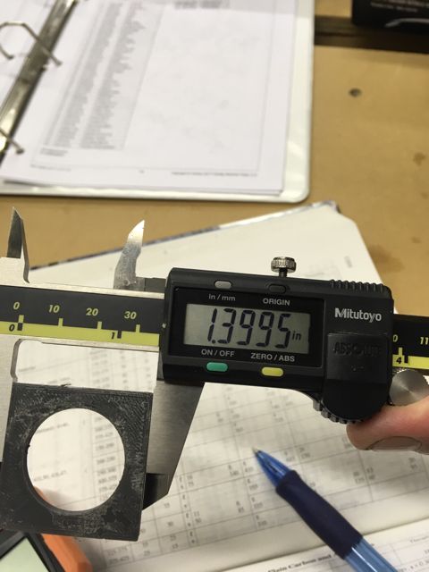

My test print in Petg shows about 0.9940 on the circle and 1.3995 on the square

I did a second print, and left it in the bed to cool, even better results. Circle was either 1.001 to 1.005
Square was 1.385
The first square I peeled off steaming hot. I'm going to try a third
