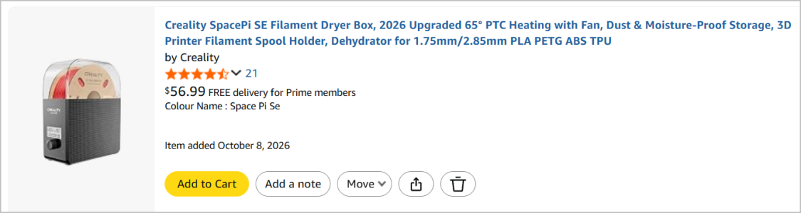

Im considering this. I'm a simple non-AMS guy so basically to dry & store so its ready for a print. There other similar ones, +/- reviews & price. Some of the ones that feed directly from the dryer into the filament lines have some shortcomings despite being on bearings. Anyone tried this one or very similar?
