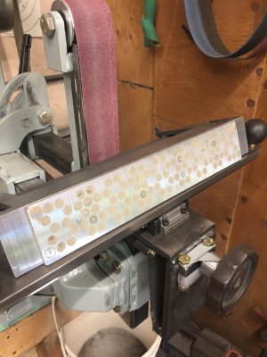

Finally finished the whole project, Jer's Gen 2 2x72 belt grinder. I pulled the 1725rpm motor off and replaced it with a 3400 rpm motor the other day and got the high heat epoxy spread over the magnetic chuck.
It is a pretty great design, I found one omission in all 5 of the plans so not bad at all.

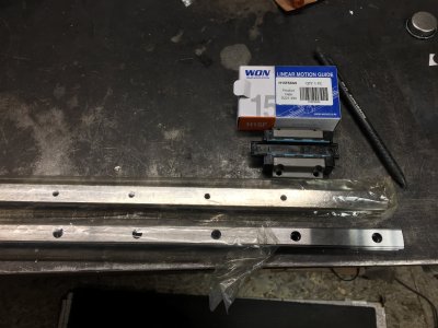

The linear bearings and rails cost $500 cnd, had I known that at the start I probably would not have built the x-y table and mag chuck.
But now that I have them I can see how useful it will be, the mag chuck really holds steel on well unless you start trying to remove too much metal on one pass.

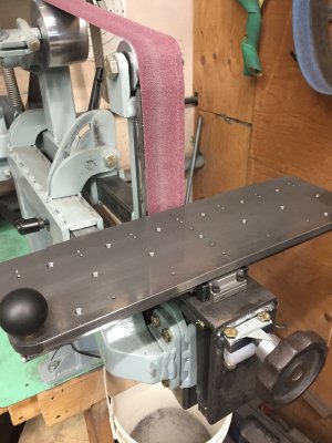

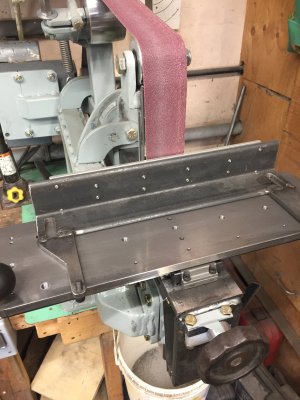

Here is the xy table,
You do have to do some delicate tweaking to get the xy table rolling perfectly square to the belt.
The xy table with the mag chuck,

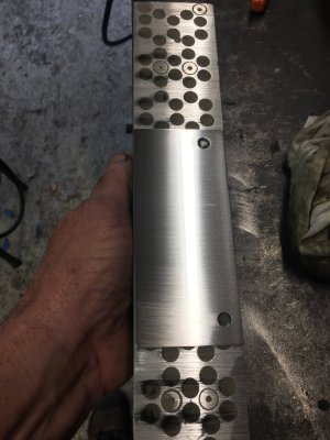

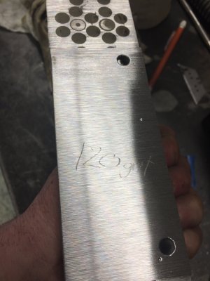

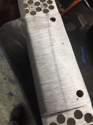

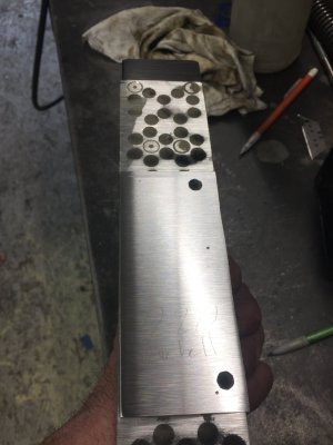

The photos below are of the first test piece of 1/8" steel plate I tried to polish up, I'm sure I'll get better at it.
This is 80grit,
120grit,
220grit,

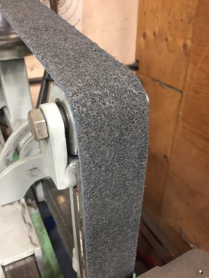

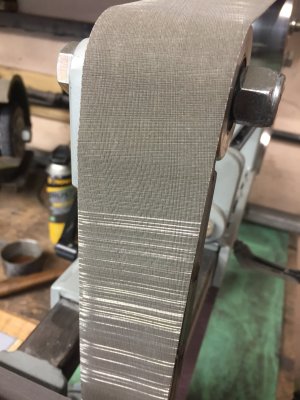

Then I tried the coarse Scotch Pad like belt, the scratches at the bottom of the test piece are from me applying too much pressure the belt pulling the work piece partially off the mag chuck.

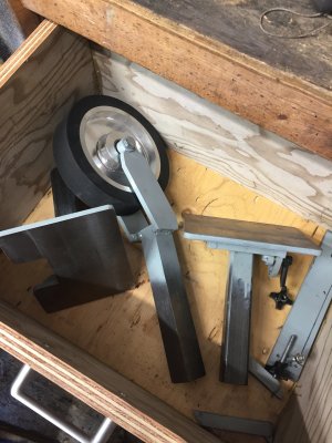

And the rest of the attachments.
So the X / Y table is to have some kind of semi precise surface grinder?
Yes, no where near as precise as a Surface grinder but as you can see from the last test piece pic, it can get you in the ball park of being ready for polishing.

I have two 3m Trizact belts and they are great, very consistent. I think they are equivalent to 200grit but they leave a finer finish than the 220grit belts that came with the belt kit. They look pretty cool too.
