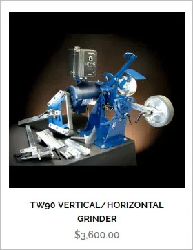

Bert, you mentioned already having a kit so this is this may not be relevant. Every time I meet a knife maker I ask him what his belt sander weapon of choice is. More than a few have mentioned a TW90. Even a few semi-pros that maybe have a bit more tooling capital $$. I haven't delved too deep into this particular model myself, but its on my list.
http://www.traviswuertz.com/
https://www.pinterest.ca/pin/303218987383772426/
Yep, that is a beauty! But Cha-Ching! Also, I have all the wheels, etc already. Reeder's RSP101 is the base grinder body plus includes two tool arms, the flat platten, hinged base so it can grinder vertical and horizontal, great tracking system and all build out of thick aluminum. AND all for $495 u.s.d Which, given my extensive search is the best bang for the buck by a longshot.
