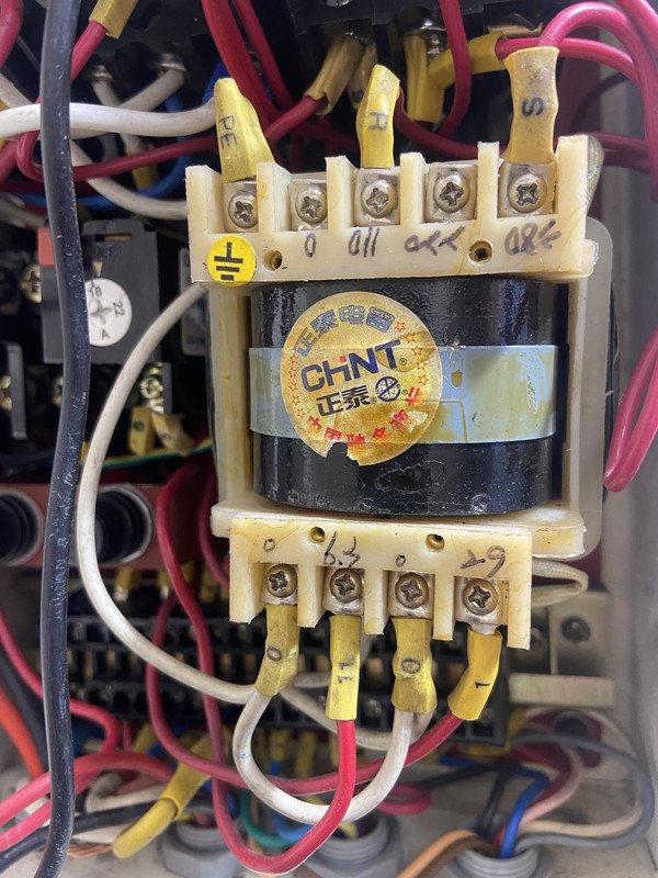

12 x 36 gearhead lathe

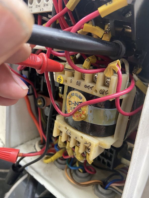

Left fuse removed, carriage in neutral, start button not depressed 0.4 Ohms.
Same as above but start button is depressed
0.4 Ohms
Ok. Now we can test between wire #2, and wire #3.
#2 is on one of the terminals of fuse # 1, and wire # 3 is one of the wires on the contactor you were testing before.
Please make sure your red e-stop button is pulled OUT all the way when performing this test.
Between the left fuse #2 wire and controller #3 wire reads 0.5 Ohms with E Stop fully pulled out
Same as above BUT E-Stop pushed in reads 1 on Ohms scale
Ok. Now we are going to measure from wire #2 to wire #6.
6 is on the A1 of the contactor you replaced. 2 is the one on the fuse.
For this test please make sure:
-E-Stop is pulled out
- Carriage switch is in Neutral/off
- the “power start” button is HELD IN PRESSED.
Let me know what you find.

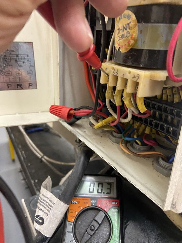

A2 contractor and 0 on the transformer, carriage in neutral, left fuse removed, start button pressed reads 1, also reads 1 when start button NOT pressed
The contacts on the bottom of the transformer also have two 0 terminals, connected to A2 start button depressed, reads 0.3

I am so grateful to Bait Master for his generous support walking through the diagnostics to resolve the electrical fault with my lathe.
I would never have figured this out on my own, plus recommending the source for a new transformer has saved me big money from what Grizzly is asking for a new transformer.
I am looking forward to getting the lathe running again.
Thanks again Bait Master!
We all have our strengths. And weaknesses. The forum here is a good place, and I ask questions and get answers as well. Metalworking is an expensive little hobby…… hard enough to get into and stay in. Really it’s no problem fellas.
I’m sure it will all work out in the wash.

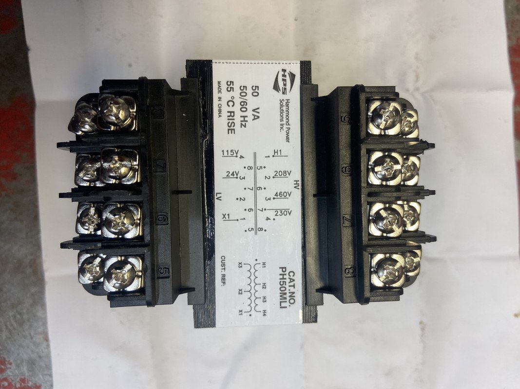

Bait Master found me source for a new transformer, very reasonable price and very fast shipping!!
It will take a bit of fiddling to fit, will just add a small cabinet next to the existing electrical cabinet. The existing transformer is smaller in size
Top connections are 120v and bottom are 24v
