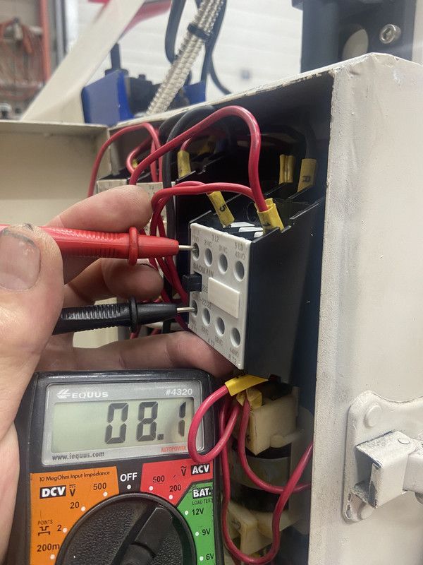

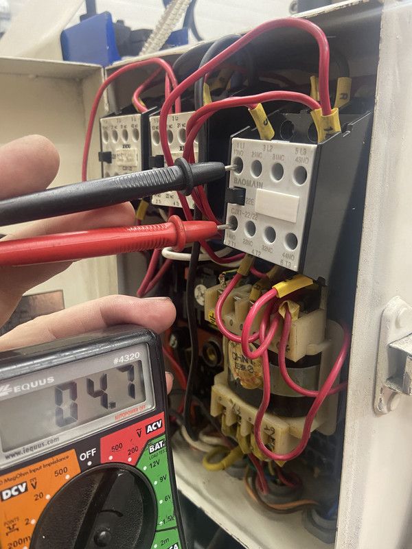

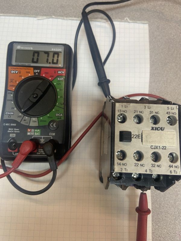

Measured the original CJX1-22 controller (the replacement is CJX1-22/22, not sure if the /22 suffix is the same as the original?)
Multimeter set to 200 Ohms, reading 7.0

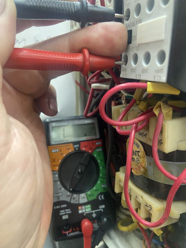

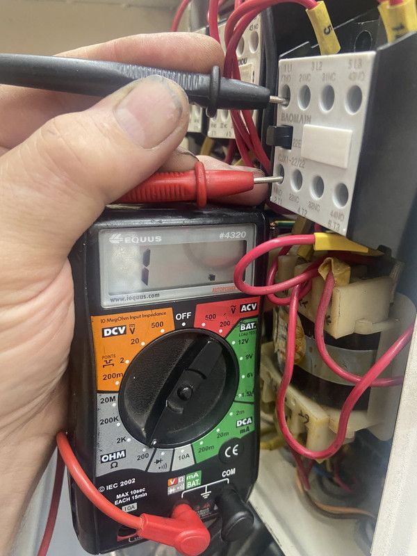

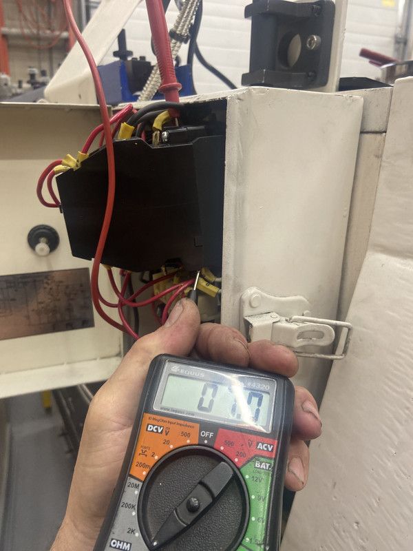

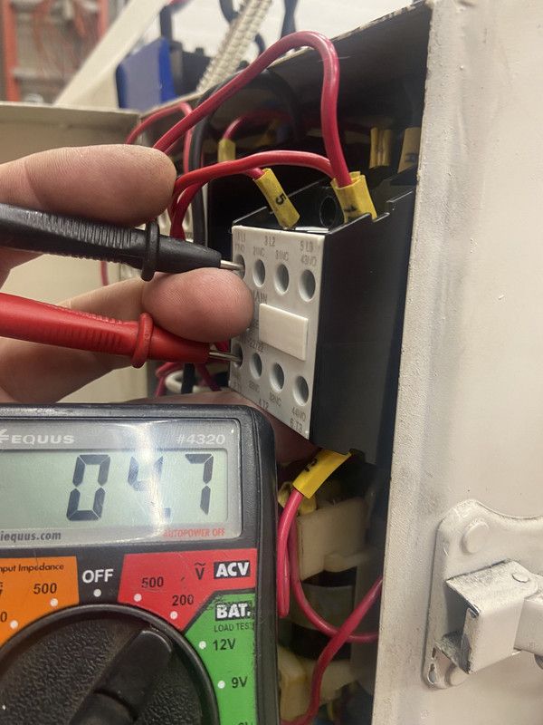

I pulled the right hand fuse to take this reading between 13NO and 14NO, carriage switch to forward
Then I had the lathe control lever set to forward and held the black button in
Same tests as above but LEFT side fuse removed
Carriage in forward. Button not depressed
Carriage In forward button depressed
Carriage in neutral button not depressed
Carriage in neutral button depressed
the left side fuse is clearly fuse #1.

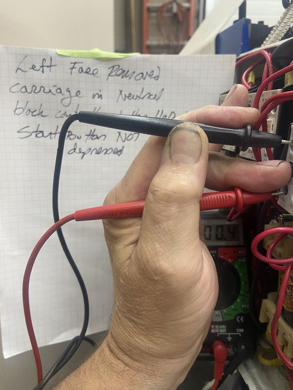

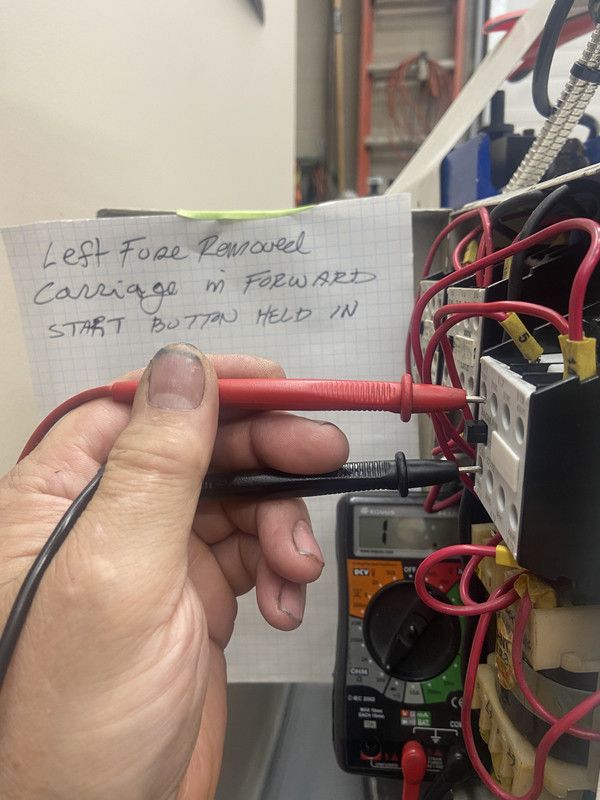

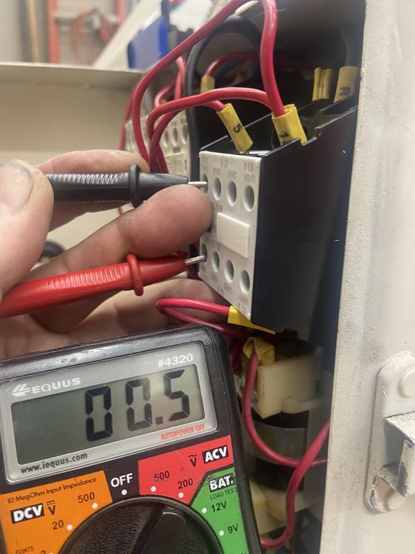

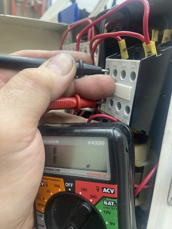

Left fuse removed. Carriage in forward, controller button depressed, Start button not depressed.
On scale Ohm reads 1
Same as above but Start button on front panel is depressed same reading of 1
Carriage in neutral controller button depressed but start button Not depressed reading 0.5
Same as above but Start button is held down while controller button is held down as well, same reading 0.5
Ok. So what I need is: Fuse 1 out, carriage in neutral, “power start” button on the front controls of lathe is held down depressed, (the contactor black button is NOT touched and NOT depressed at any point during this) then the reading taken. This reading should be 0.0.
Then when the “power start” button on the front of the lathe (not the contactor) is let go of, the reading should go to the “1 . “
When the “power start” button on the front of the lathe (not the contactor) is held again, it should go back to 0.0.
Then if the carriage switch is moved to forward or reverse while the “power start” button on the front of the lathe is held down (not the contactor) it should also go to “1 . “
This whole test is performed without pressing in the contactor. We do not need to press the black button on the contactor at all during this.
Let me know when you have this done. The pictures are great.

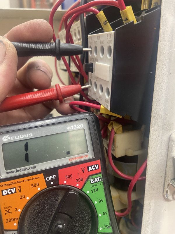

I have completed the tests:
Left fuse is removed throughout these readings.
Carriage in neutral and power start button held down - 200 Ohm scale reads 0.6
As per above, release power start button - reads 1.0
As per above, again hold down power start button reads- 0.6
Carriage in forward position, power start button held down reads - 1.0
Carriage in reverse position, power start button held down reads - 1.0
