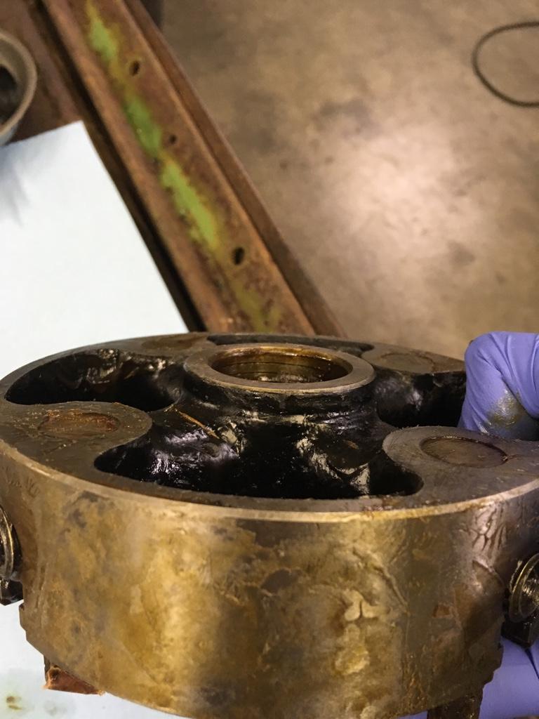

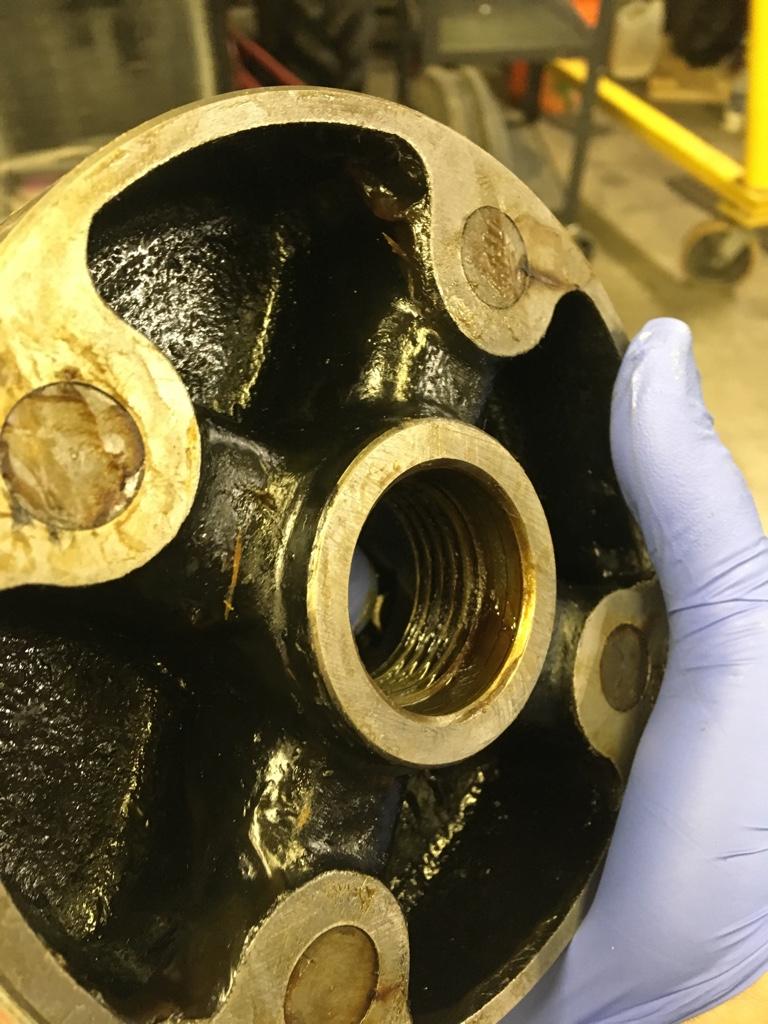

can someone post a picture of the 4 jaw they got? Can it be machined to be a plain back? How about 3 jaw?
I’ll post pics of the 3 jaw later tonight, it is in disassembly right now. The threaded backplate came off simple enough, could probably machine another easily. Really nice fit of the threaded backplate though ( could hardly seem the seam )
