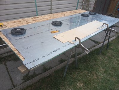

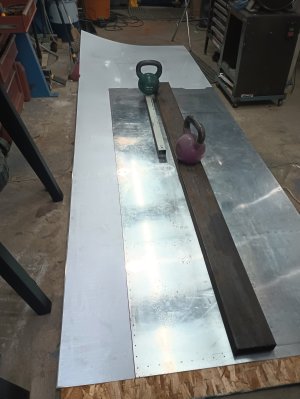

Raining where the taylor is, not raining in Calgary, had some time today and felt like doing some work on the 601, or rather forced myself to do some work on the 601, lol
Been procrastinating about replacing some of the wing sheet metal, decided to just get to it today. After screwing around with the cowling a bit i went after the right top wing skin, it has a good number of scars from hangar rash, probably ok, but it bothered me
Pretty easy work, just lots of drilling.....after clecoing the new sheet on it really makes me want to replace more sheets......but at 240$ for a 4x12 of .016 i dont think i will be doing that

2024, I would have used 6061 it being slightly cheaper, but no availability (Russel)
I can get a 4x8 (20 or 22 gauge, can't remember) of 3003 for about 50$, it just isn't the right alloy

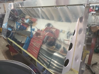

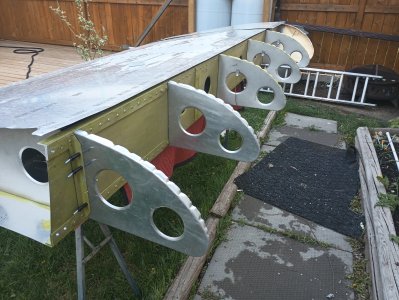

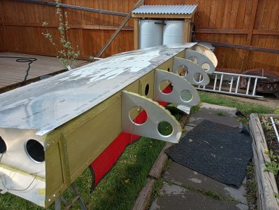

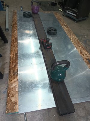

Some progress today on replacing the leading edge and 2 ribs on that wing, ive been dragging my feet on getting this done, figuring i needed help to get the wing outside to work on. Turns out having the leading edge sheet mostly drilled out already allowed me to pick it up by the wing spar and one man it outside with little effort.
Drilled out the remaining hundred or two rivets, pulled the leading edge off, you can see one of the damaged ribs still attached

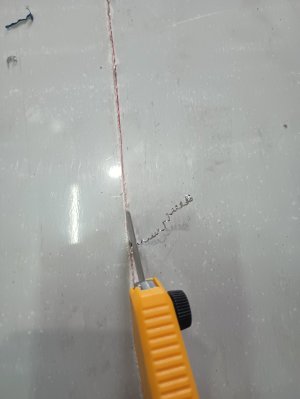

went for a cruise to KMS to grab a specialty olfa knife, a PC-L, made for scoring plastics, i cut the wing skin with a standard olfa knife, that didnt work great, apparently this is the knife to use....and boy is it ever, works so well it even makes little curlys. it worked out, as it poured rain while i was gone, got back and had to move the sheet cutting indoors
and match drilling a pile of holes

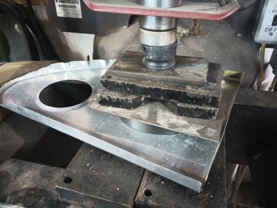

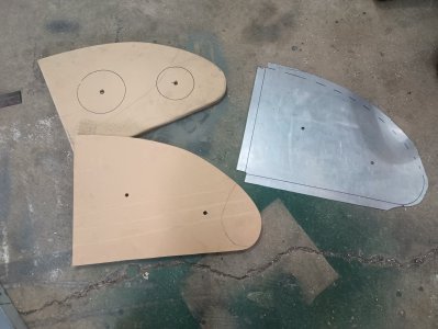

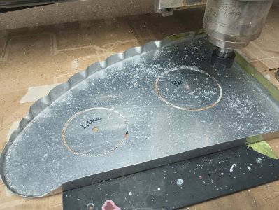

I was about to call it quits at this point, figured i was ahead.....then ambition got the better of me and i decided i would give making the new ribs a go, i cut them out of the old leading edge sheet with the band saw, hammer formed over a blank i made a few months ago, used the cnc to cut the holes ( best and easiest way i had to cut the large holes in such thin material), and flared with the 3d printed flaring dies
and installed on the wing spar, i will drill the skin holes in the ribs out when i get to installing the skin. At this point i need to find a 4" diameter pipe 8 foot long to form the bend and it will be ready to install
View attachment 64523View attachment 64524View attachment 64525

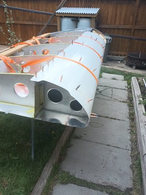

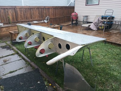

I did manage to get the skin bent and installed, that was much more difficult that i anticipated, i ended up with a few "educational divots" trying to form the le skin, nothing big enough to cry about or replace the skin for, i will just have to live with them, or fill them when i paint...but filler adds weight, so probably not, lol
i also did figure out how im going to change from flexed skin ailerons to a hinged aileron setup, needs parts now
