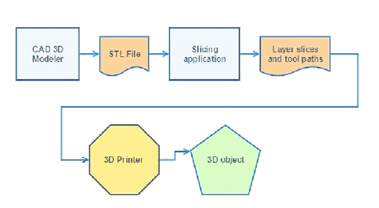

"STL code" doesn't exist/is not a term. An STL is the file format/extension of your 3d model. ".STL". Almost every CAD program out there can save a model as an .stl file. That's it, that's the extent of the knowledge you need to know about that.
"slice code" doesn't exist/is not a term. "Slicing parameters" would perhaps be a better more accurate term. A "slicer" is the software program (cura, Bambulab, etc) you load your 3d model (stl file) into. It's job is to take the parameters you specify such as infill density, perimeter lines (shell thickness), layer height, print temp, bed temp, etc and generate the "G code" that the printer then uses to drive itself. Don't be alarmed about all the parameters. Most are simply default based on your material selection, and you can get as in depth, and hands off with those as you like. Have a part that needs to be strong? make it a denser infill, with a thicker wall/shell etc....You can use slider bars to change these parameters (or input text), and see a visual representation of your printed part change in real time on the screen.
"G Code" is the language of code that the printer (and almost ALL CNC machines) uses to drive itself to the specified coordinates in order to print your part. If you understand the Cartesian coordinate system (I am assuming you do based on your engineering background...) , all g code is, is essentially a simple text file of instructions telling the machine where to go, how fast to do it, and what to do when it get's there. That basically it. For the 3d printer interface and workflow, you don't even touch/look at the gcode, or even need to know what any of it means. The slicer handles ALL of it. I'd probably throw out a guess that over 90% of the worldwide printing community couldn't read a line of Gcode and tell you what it means. It's knowledge thats simply not needed to print parts. Aside from my initial curiosity, I can't tell you the last time I actually looked at the gcode for a print file let alone edited it.

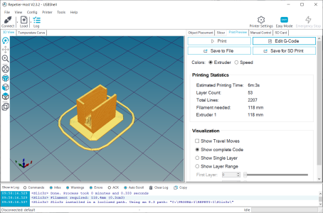

Here's the basic process:

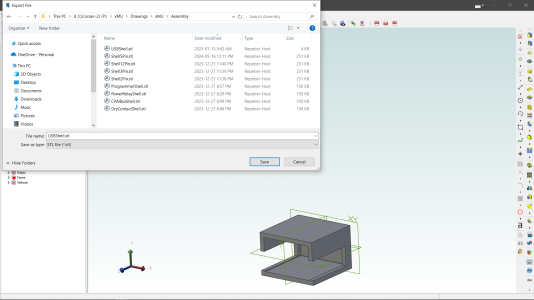

1. Need a cover for the USB connector while spraying conformal coating over the entire PC boards. Masking tape was originally used but very tedious.
2. Draw up a slip on cover and export as an STL file

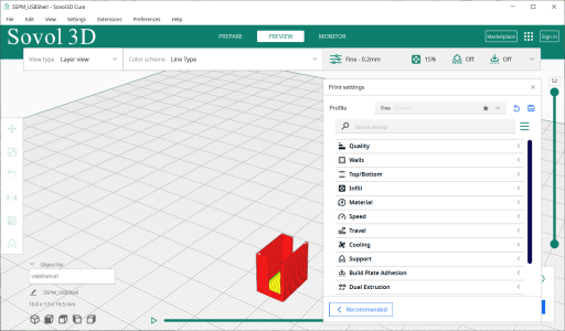

Setting the parameters of the STL file. Notice that one custom value maximum allowed angle. That's the part that makes round stuff a bit faceted but results in faster prints. Not important for this one with square edges. But if you see a print that doesn't appear very round this is why.
3a: Run whatever program that imports the .stl file and slice it with whatever parameters suit the job. In this case it's the SOVOL slicer. This is the hardest part of 3D printing where you may not know what is best. But there are defaults for each print quality that work well enough. And that get's then saved as a .gcode file for import into your printer.
3b: Or the Repetier slicer (which is now old). Also save as .gcode for import into your printer.

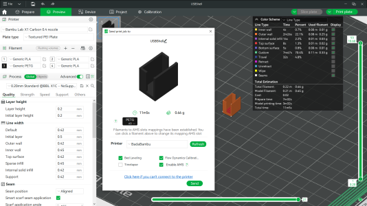

3c: Or if you have the Bambu you import it directly into the user interface and slice.
At this point all three systems, if connected to your printer can directly print. Or you can save to a MicroSD card and use SneakerNet to walk it over to the printer and use the printer front panel user interface to select the file and start printing.
For 3c: One clicks on the Print Plate tab on the top right and then select some more printing parameters like bed leveling etc.
And then the file is sent over the cloud in this case to the printer which heats up the bed, sets up the filament etc. and finally starts printing. The Bambu X1C comes with a camera and an interior light so I can watch it remotely as I'm doing now.

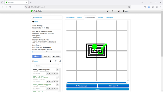

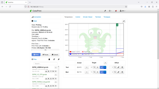

For 3a and 3b: I used a Raspberry Pi and OctoPrint software to connect to the 3D printer USB port. From there I could remotely download and print. Just drag and drop the file onto the user interface and tell it to print.
I have a camera on the Pi3 and can look at the print.
And I can even watch the progress on a per layer basis while it's printing.
