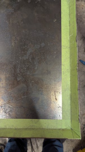

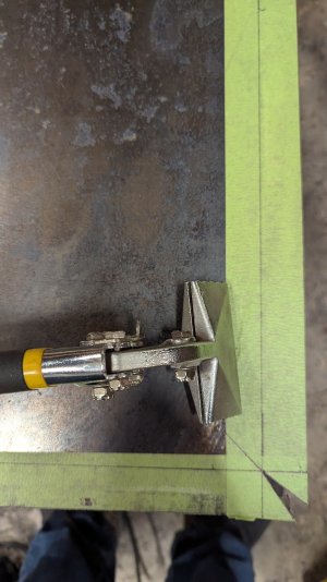

I am making slow progress being summer time. I managed to get over to Beach Rd steel and picked up some cheap 20 guage sheet. I want to make side panels for the stand and make a chip tray. I cut to size on my foot shear and used a zip blade to cut the corners. This hand bender worked well to about 45 degrees. Finally weld the corners.
If I find the edges too sharp, i might weld on some 1/4 round stock around the perimeter.
