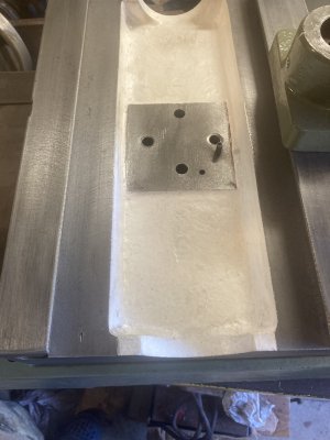

Just a bit of an update. What a pain this thing has been to get apart. Someone used grease at some point and the cross slide jammed up with crud. I backed off the gib screws, and removed the main cross slide screws. And by using wood clamps able to force the slides along. last picture is the bent gib adjuster screw. It’s going to require some carefully straightening. Any suggestions?
Next is cleaning and painting.

Seems like old machines are like old machinists. Stubborn, worn, stuck, and survived a few operations. Glad you found a way to get it apart. I'm with @David, don't bother straightening it. Not only are the threads damaged, but you can't really "bend it back" without still further weakening it. Just make a new one.
That's almost impossible to fix. Even if you can over bend it back to get it straight without destroying the threads, the grain structure has been irreversibly damaged by yielding.

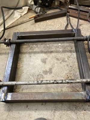

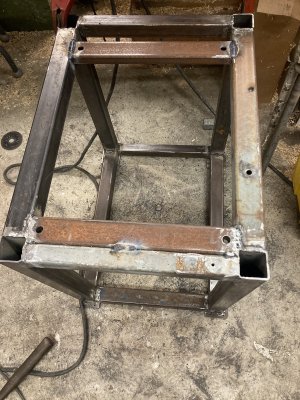

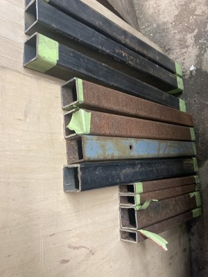

Just updating my thread, stick welding up the machine base with my amateur welding skills. Using up a few scrap pieces along the way. The base will have casters and drawers. I bought some sheet steel for a chip tray. Steel is expensive these days

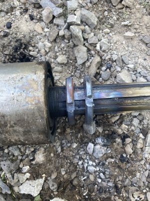

The bearing nuts were a pain to remove, ended up using some heat to break them loose. I wanted to double check the sizes before I order replacements.

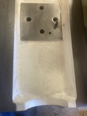

I paint is done, the inside surfaces have coated too just in case someone looks one day.
