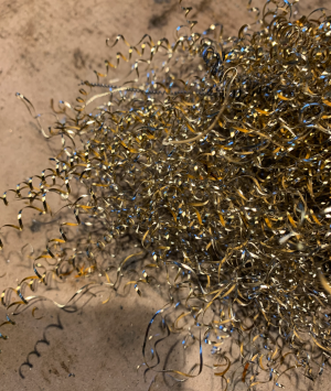

Saga continues... I made a bronze insert and bored out worn thread on original nut. BTW. I suspect that nut already has been replaced - see radial slots accuracy.
Here is first thing that I noticed. Chips from nut were stringy and long while my bronze chips are crumbly and not forming any swarf. Sound during cutting is also quite different - hissing noise while boring nut vs. "sandy"/"grinding" while turning insert.
Here is swarf from nut.
Secondly - I couldn't make nut to get "primed" with tin/silver solder. No matter what flux or temperature - it just not soldering ...
Finally i TIGed it with bronze welding rod - barely made few spot welds.
This allow is nightmare to solder/braze/weld. What it can be? Does it looks to you as aluminum bronze ?
I don't know if this will help you figure it out, but in this picture the piece on the left is C954 (aluminum bronze) and the piece on the right is Everdur (silicon bronze).
Real aluminum bronze ought to have enough iron in it to be able to feel it with a magnet. The "backyard" version some people make is usually just 90Cu/10Al though. Hope that helps.
