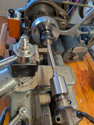

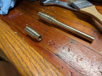

Working on my South Bend 9C

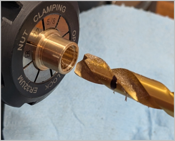

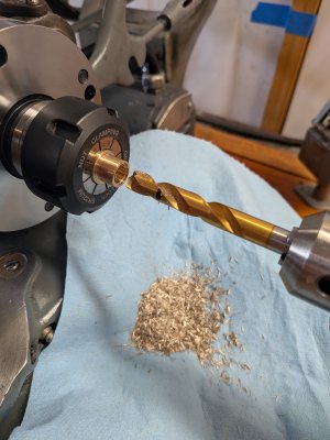

Worked up some new mandrels over the past week but I'm not pleased with the runout on them after trying them today. Ordering some more brass rod to try again...

Not quite sure what your operatons are & how it relates to the steel part, but are you counting on the drill for concentricity in the brass part? It will be heavily influecned by center drill pilot (or not) & the drill itself wandering. A better geometric & dimensional surface & would come from roughing the bore with a drill & use a small single point boring bar to hit the ID.
I'm currently waiting for the right size insert to arrive so I can bore out the next version in fact (target ID here is 9.2mm).
That one isn't as bad as the other, inner, mandrel.

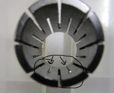

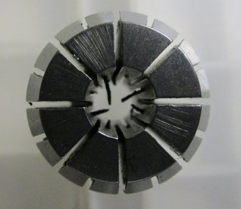

Hi Michael,

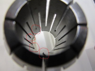

Have you checked that your collets are clean !
I used to get runout problems until I discovered this... See pictures.
Bear in mind that these collets were brand new Chinese, unused ones, My 0.5" Regiofix is as clean as a whistle and spot on.

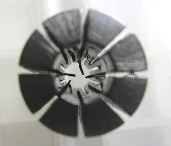

Just look at the swarf from slotting in the cuts.
The problem is that the first time that they are used the bits get compressed and are then very difficult to remove. Your work will get pushed to one side when you tighten the collet, causing run out.
If you don't see them and clean them out it will create a long term problem. I use a Stanly knife blade and a ground down hacksaw blade, to remove them.
I've had this problem too. It's almost a standard feature of Ali Express Collets.
Had a really bad one once. It took a magnifying glass to see and remove the last of the burrs.
Hi Susquatch, Guys,
Its the small ones that are difficult to clean up. I have used 3 mm HSS rod to scrape off the burrs, if you are careful you won't damage the collet. The alternative is small abrasive sticks the smallest that I have got is 4 mm, they are hard but will snap easily.
The technique is to clean the slots with a Stanly knife blade using the back edge as a scraper. I clamp the blade in a block of hardwood to prevent cutting myself with the sharp edge. Then stone the inside edge of the slot, using oil helps.

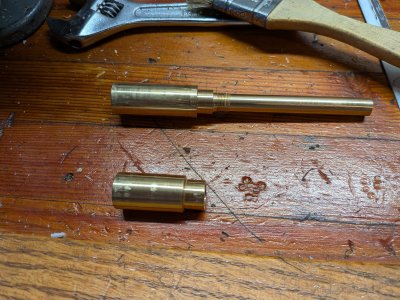

Well, may as well toss it here for input before I go again. My attempted production of the long (internal) and short mandrels. I don't have the dimensions on me, but they fit a 5/8" collet, for a sense of scale. All work held in said collet.
Long internal mandrel
1. Short amount of rod extended, the length of the "base".
2. Face the work, center drill for a live center.
2. Using the live center, turn work down to 0.625".
3. Flip the work so that it's held by the base, as it will be used.
4. Face and center drill.
5. Using the live center, turn down the steps as seen (including the long thin portion).
6. Trim and face the thin end as needed.
7. Cut the threads (yes, I'm still using tap and die).
Short mandrel
4. Face and spot drill.
5. Drill relief and to depth. (Next time I'll try boring).
6. Tap.
The one and only thing that jumps out at me is those threads. E everything else "looks" amazing. Well done!
The thread leads (both start and finish) are not great though. I believe that's probably the result of using a tap and die and all the limitations of that. Taps and dies are probably good enough for production parts, but I'm thinking they are not good enough for your mandrels.
Basically, I think of your mandrels as masters. That's not the same as production parts. To make good production parts, your mandrels need to be better than production.
My advice...... Time to learn to Single Point.
Yeah, it's still on The List...
Well at least the method seems sound. Hopefully take 2 won't be all wobbly like these ones...
One of MANY advantages to Single Point threading is that you can make threads as tight or as loose as you want them. They don't need to be generic. In fact, you can even cut them to perfectly match a given tap or a given die.
That said, another error that most of us make is thinking that a tight fit is good. It's the cones of each thread bearing against each other that make for a solid fit. The threads distort and deform intentionally as they are torqued up. This isn't intuitive.
