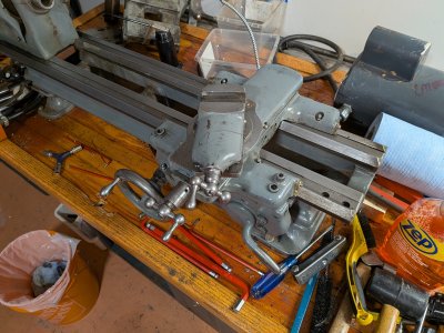

Working on my South Bend 9C
You know I really considered that, but the wall in my available space was just not an option. Getting into a shallower table would have been so nice though.

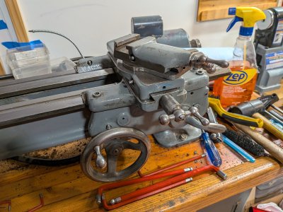

But, carriage is done! Will work on making space and doing the math on rear drive placement.

A side benefit is that I can turn the lathe easily by hand but it is unguarded so it requires care and attention.

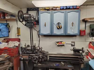

This is what the drive looks like on my sb9 (not built by me)
That looks very much like the drive system on my 1880s vintage FE Reed Lathe. Even to the boxy angle iron motor stand and overhead line drive system. I didn't make that for mine either. The guys who did that for our machines probably both subscribed to the same magazine and read the same article. There was no internet yet when my machine was converted.
Actually wall mounting as I did wasn't a good idea sound wise.

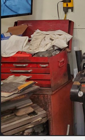

Be still my heart! OMG Don. That's drop dead gorgeous! First time I ever saw a drawer being used as a surface. I think you are my new hero!

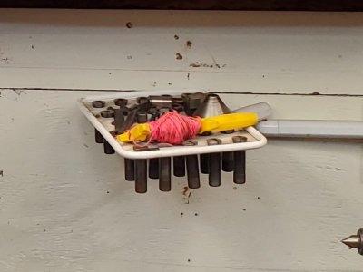

So, what is the string for?

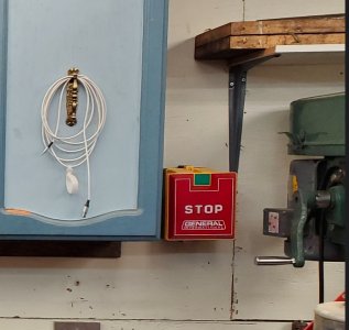

Had trouble finding the E-Stop eh.... LOL! Gotta be the biggest one I've ever seen!

You think your drive system is loud upstairs, I can only imagine what it's like when your shaper is square dancing!
140 mower, i know what you mean about the wall mounted countershaft.

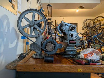

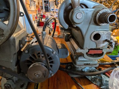

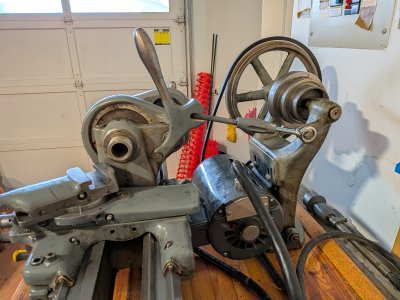

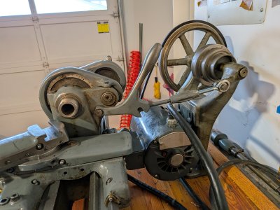

I reckon for the next step I should dry mount the drive assembly so I can calculate belt length.
I leaned my entire countershaft/motor ass'y forward about 4". It meant that I needed to get a new turnbuckle (a la Princess Auto), but it also gave me that much more space. I think I could have done that, plus moved the ass'y closer to the lathe a few inches for an easy gain of 6" or better.
A little more juggling things around this morning. Gotta grab some different mounting bolts for the motor and will need to get that in place and get a longer v belt. THEN I can figure out placement and drive belt length. Baby steps.
A piece of 5/8 rope should give you the vee belt length, and your wife's sewing tape measure will get you the flat belt. Just be sure to make all your adjustable mounts etc. set to the middle so you have some adjustment either way......
......Now, quit making excuses and get us some chip pics.... 😛
A little hardware visit today and we have some drive assembly progress. Loosely bolted in place so I can calculate belt length before stripping it down for a more serious clean. Hoping this looks right - definitely kind of tight clearances.
