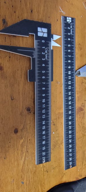

I like to keep a set of calipers around for fast measuring of 'stuff'
These are ultra smooth and surprisingly accurate. Every day I'm impressed with the Bambu x1c
What material is that? I'm just making up a "No Flyers" sign. Was planning on black and white. It's going to be outside so I figured I would try ASA.
elegoo rapid pla+ for both colors.
Its cleaner than it looks. My husky pup is shedding and its everywhere..

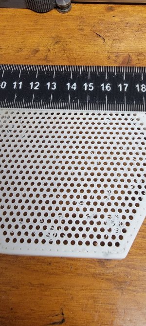

It looks great. The contrast is good. The mm markings are really good. I was trying to print a small gear with my old machine. I think I'm going to try again on the X1C just to see what it does. I printed some desiccant boxes out. Take a look at the small grid in these.....
If it can print that grid, I might be able to make my gear.
That gives me a good idea. Maybe I will try printing a grid of gears. Cut out the best one from the grid. Another project on the list. lol

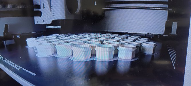

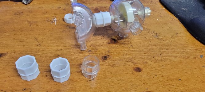

My boy likes Capsela. Its a building toy with gears and stuff. I played with it when i was a kid too. Anyways, all this stuff is old. The capsule couplers are all cracked. So tonight i went on thingiverse, and sure enough, there's what i need. Started printing a few at different scaling to check fit, canceled it when they were built enough to test, and now that its dialed in, its printing off a lifetime supply. 20240226_040528.jpg20240226_041005.jpg
My boy likes Capsela. Its a building toy with gears and stuff. I played with it when i was a kid too. Anyways, all this stuff is old. The capsule couplers are all cracked. So tonight i went on thingiverse, and sure enough, there's what i need. Started printing a few at different scaling to check fit, canceled it when they were built enough to test, and now that its dialed in, its printing off a lifetime supply. View attachment 44656View attachment 44657
Jesus! How many more kids are you planning on?
Those do look handy. They appear to have a Vernier Scale too, but when I zoom in, it just looks like a regular scale. What the heck is thy all about?
In my case, I have just a regular 6" and 12 " steel ruler, and a tape measure. I don't have any plain calipers. I think plain calipers would be very useful to have handy on my mill and my lathe.

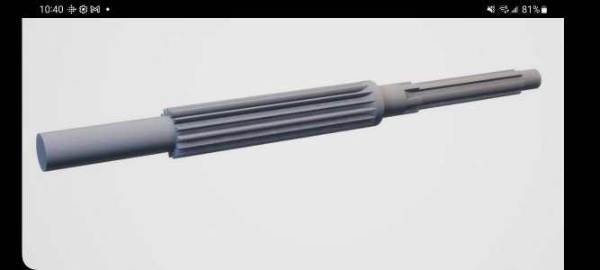

Along with software suggestion I will put in a vote for solidworks if you are doing more technical stuff. I've only done 4 of the lessons for it, and 6 months of practicing on my own stuff. ( got a copy of their training book from a co worker ) and I've just completed my most complex part yet, the splined shaft for my quick change gear box on the colchester. Dont get me started about crash course on gear cutting and design. But the thinner splines are 15t DP16 at a 20 deg contact angle, which solidworks has a tool for. (Edit: after my test print they are 14.5 degree it seems)Screenshot_20240226_224021_OneDrive.jpg

Along with software suggestion I will put in a vote for solidworks if you are doing more technical stuff. I've only done 4 of the lessons for it, and 6 months of practicing on my own stuff. ( got a copy of their training book from a co worker ) and I've just completed my most complex part yet, the splined shaft for my quick change gear box on the colchester. Dont get me started about crash course on gear cutting and design. But the thinner splines are 15t DP16 at a 20 deg contact angle, which solidworks has a tool for. (Edit: after my test print they are 14.5 degree it seems)View attachment 44712
Calgary Library has free online courses. Lynda- Solidworks is worth checking out. Short follow along videos that get straight to the point.

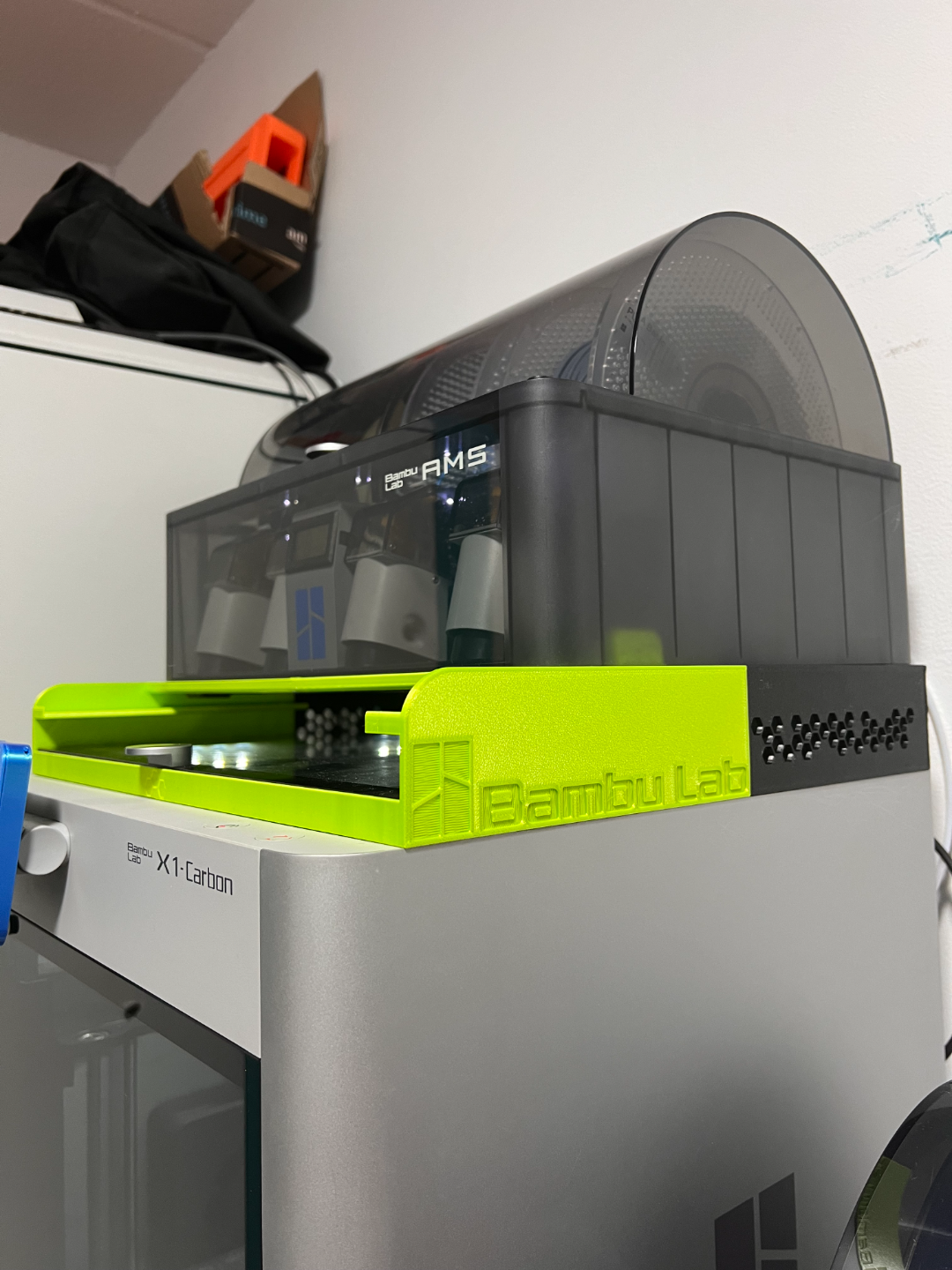

Ok a few photos to make this less dry. Woke up to another PETG print success. Assembled and installed this evening.
One item I do not like about the Bambu X1C is the AMS sits on the top glass. You need to take that glass off for some materials. With the glass off there is no place for the AMS to sit. I did not design this riser. I downloaded from link below. It lifts the AMS up off the glass. The top glass can be removed and slid into a slot to allow for venting. There are many designs out there. This one was simple and clean.
Riser link
I've seen the AMS mounted on a wall shelf behind the printer as well. Slightly longer cable and PTFE tube and you're golden.
