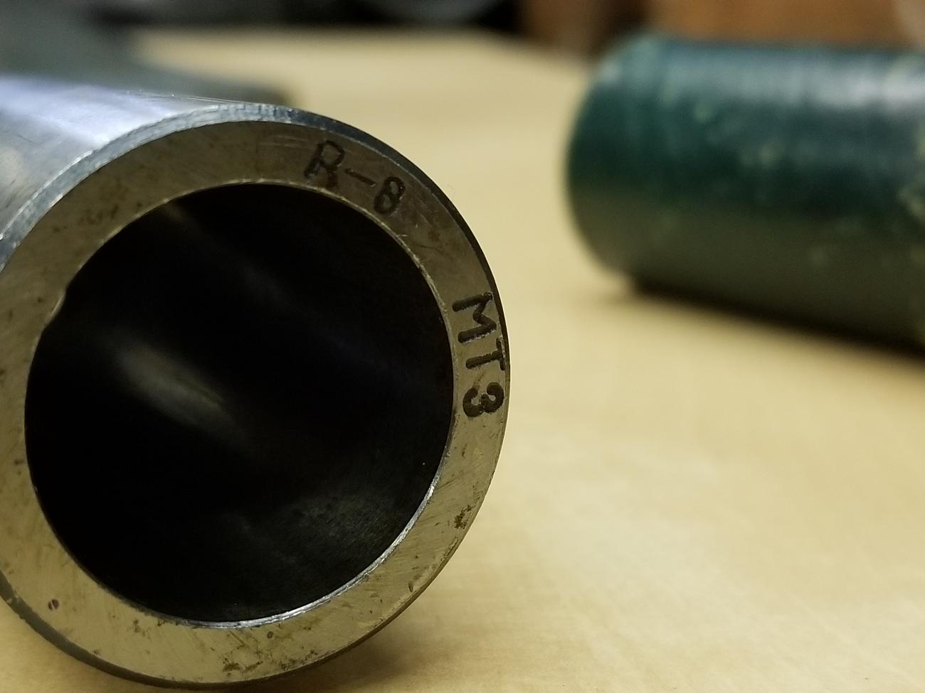

Almost all my tooling is MT3. But the mill did come with a few R8 pieces. Not sure just what yet. Hopefully the most popular shanks.
Here is an R8 to MT3 adapter. I assume you mean that the over a length with R8/MT3/Bit all stacked up is the problem.

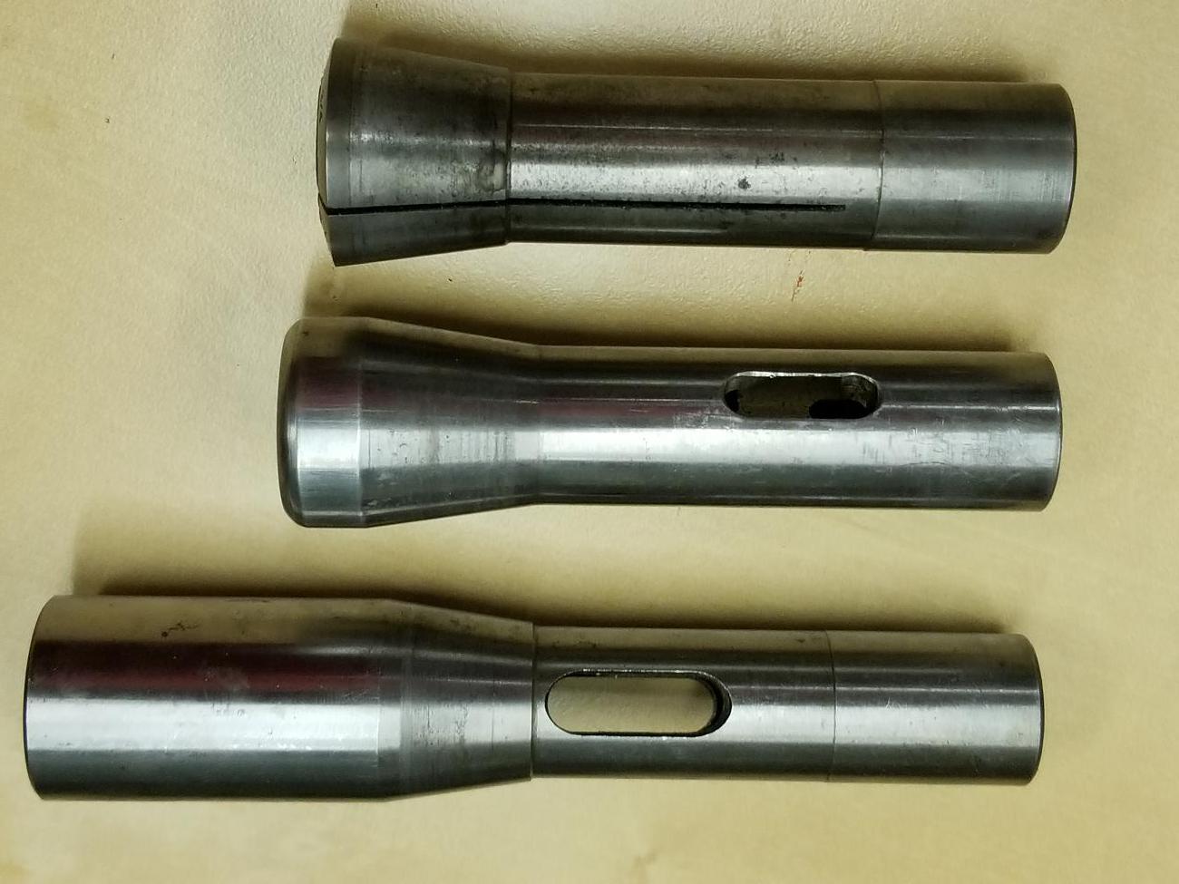

Unless I'm just in lala land (always a possibility) that's an R8 to MT2 adapter. Do you have MT2 or 3 tooling? Working from home let goof off and go grab some photos.

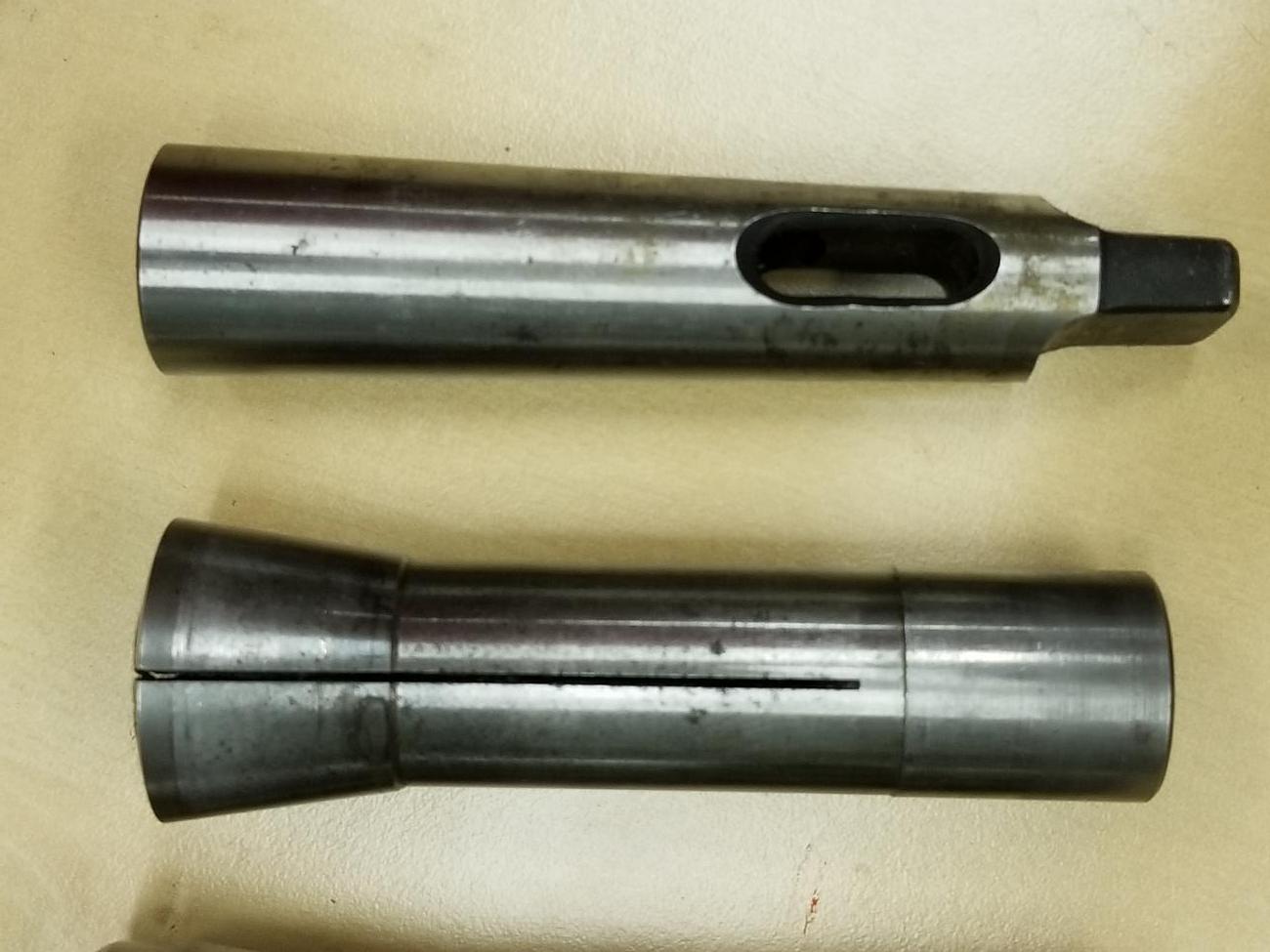

This is a an R8 and and MT3 taper - The OD of the MT3 diameters are too great to have an adapter inside the R8 spindle
This is an R8 to MT2 vs R8 to MT3 adapter - using the MT3 the tool is held 2 or 3 inches below the bottom of the spindle. It will work, but will be far less rigid - that overall will leverage the laterial forces from milling. its ok for drills as the force axial. It what you have is mt2 tooling is should work ok.
shot of long one above just to confirm to myself I wasn't losing it
All three, R8, R8/MNT2 and R8/MT3

It was just a photo off of the internet based on a search for the adapter. It was labelled R8 to MT3, but I'd guess they used the same photo for all three varients. Looking again, it seems most of the outfits do that. They are probably afraid of scaring a guy like me off.... I'm no expert at such things though, so I simply drank the coolaide.
My stuff is definitely MT3 though. My lathe tailstock is MT3 and so is my Mill/Drill. Unfortunately, I deliberately tried to avoid buying anything with adapters. I always preferred a one-piece integrated MT3 shank. I didn't know then what I know now.
The other problem is that I have a fair amount of it. Everything from small and large Fly Cutters, Gear Cutting Hobs, slitting saws, a set of really nice Weldon Hole Saw Shanks (love these things), to assorted size milling bit holders. So I'll prolly get an adapter even if it does limit my working length options.
As you can see, there is a little MT2 stuff, and even some MT1 stuff, but I have adapters to handle that already.
The mill I am getting cones with an R8 drill chuck but I have no idea what kind of quality it is. Too bad though because I have a drop dead gorgeous MT3 chuck (not in the photos) that I got for my lathe.
@Susquatch : the one issue I have had with the MT adaptor on my mill is that there is no draw bar holding the Morse Taper, only the adaptor. If you are putting downward pressure on something like a drill, the taper held no problem...but....when I was gear cutting (mostly side load) the taper rotated on like the 30 th tooth and screwed the part I was making. I machined off the taper and use the cutter holder in an ER collet now. If your MT3 stuff has a draw bar thread (as it looks like most of it does) you may want to figure a way to engage that? not sure it is possible?

Yup, I've had that problem too. When possible I either drilled and tapped the Morse Taper to take the draw bar or machined a flat in the taper to take the set screw that is built into the end of the Spindle on my Mill/Drill. It's never failed me. But that will be an issue with an R8 to MT3 adapter. Maybe I could get two R8 adapters and drill the drawbar hole out so I can use a longer drawbar that goes right through the R8/MT3 adapter into whatever MT3 tooling I'm trying to hold. ????
