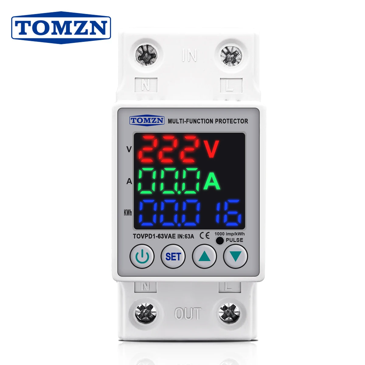

The two readouts:
Both devices are < $10 Aliexpress commodity type items. One is a thermostat for the little fan that actually never turns on because the temperature in the case never seems to go over about 35deg C :rolleyes: well at least I planned ahead. The other is an over-voltage relay set a shade over 220V. The drives I'm using are rated for 220V. The manufacturer spells out the absolute upper limit pretty clearly IIRC 242V. So I dug through my transformer box and found a 240:24V and instead connected it as a buck transformer to give 220V@20A. If nothing else that over voltage relay gives me a warm and fuzzy feeling displaying its "221V" so I know the drives are powered and how much total current they are pulling, which is usually not very much.

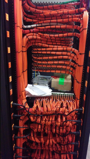

When I worked in the US doing telecom facilities,, this was the type of organization that was expected.
