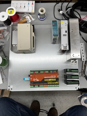

Comments from the peanut gallery.......
1) Try to keep your signal and motor power wiring physically separated.
2) Keep all wiring as short as possible. Turn those servo drivers 90 degrees so the power connectors are close to the supply, and the motor wires can exit the case to the RHS.
3) Avoid making wiring loops (they make great antennas)
4) Don't daisy chain power, especially if high current, wire each driver back to the source.
5) Twisted pairs for signals for example "step" are better than a bunch of single conductors.
6) The G3 drivers have differential outputs use them instead of single ended.
7) You might need a small fan at the top of the enclosure for cooling (probably not) but would be wise to have a little space if needed.

Good call on rotating the drives. I was thinking that would be a better orientation.
One design consideration is that the enclosure has a opening in the bottom that is probably 4" x 12" which is where I'd like all the cabling to enter/exit.
All of the servo cables are pretty stout, thicker than a 14/2 extension cord and there are eight of them that have to snake their way in. Two have to go to the drive in the upper left corner.
The cables all have non-removable plugs molded onto them so they are going to be trickly to manage.

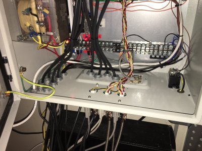

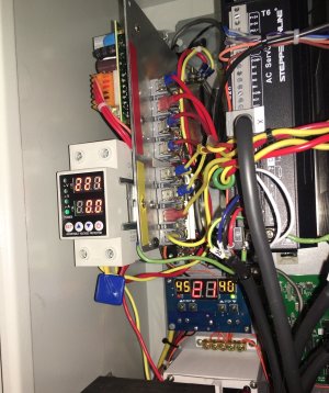

A few images from my mill panel that might help....
Notice the yellow & red power wiring to the T6 drivers, it might be messy, however it's kept separate from the control wiring above and is as short as possible and there is a separate feed from the source to the driver no daisy chaining. I added a ferrite bead for good measure. In hindsight I should have run the control wiring to the right instead of the left to avoid the power wiring altogether, as it is it crosses at 90 degrees so fairly benign but would be better the other way. Also note the control wiring is all twisted pair, tip of the day use your cordless drill to twist the pairs.
The T6 servo connectors are quite large, however by temporarily removing the shells (T6 end) and drilling out the center protrusion of the cable clamps (note round holes in center four cable clamps) I was able to get the encoder cables through standard cable clamps.
I need to share the DRO pickup data because I have a separate DRO and also need to get the DRO signals back to Linux. So I made a simple DB9 splitter PCB that mounts to the bottom of the cabinet, and uses small JST connectors to get the data up and into the cabinet to the MESA board. Not having to make ten DB9 cutouts and then parallel the wiring was well worth the $10 cost of the splitter board, and was a great excuse to use the Greenlee punch for three more holes. BTW Greenlee does have DB9 punches, but Mach also has a wizard for electrical shapes.
For the cable clamp holes, I have a set of Greenlee punches and they make for nice clean holes. If you don't have Greenlee punches a step drill is a bit messier but will get the job done. Any excuse to purchase new tools is a good excuse so If you do go in search of Greenlee punches just be aware that the advertised size is not the actual hole size, it's the conduit size. These Greenlee punches are plentiful on Kijiji I think I paid $25 for a complete set, the old ones with the bearings are the better ones if you get to choose. Apparently the Amazon clone specials are complete and total junk from what I have read.
