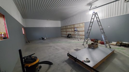

Besides the lack of easy mounting, anyone else hate the have issues in the shop that isn't because of install (muding taping sanding etc)? I'm leaning towards drywall right now for my new shop because of the price of plywood but also because it will be a brighter space that my partner is nudging me towards. My concern was is keeping it white and generaly durability but I'm thinking of committing to keeping a clean shop and doing messy work outside.
I used 1/2" plywood in my shop because I wanted the flexibility to mount shelves etc anywhere I wanted. I painted it white and it's been great. 100% would do it again.
Painting is easy if you roll or spray
My buddy who is in construction used 1/4" sub flooring instead of plywood or drywall. It turned out awesome. If I ever build another shop, that's what I will use. It is inexpensive compared to other options and looks great. It would need another layer on top of it if you wanted to hang tools on it. But it's fine for cabinets or shelving.
I used 1/4 flake board and 1/4 Masonite free from movie sets. I was a tight budget 20 years ago. I would probably use 1/2 plywood if I did it again. I will have to look up our cheapest finished plywood at work is going for.

I put D-grade 5/8" plyood on the bottom 8ft of the walls. Painted it with gray floor paint before outting it up. White tin above to and with the ceiling. Love it, I hang stuff of.my walls quite a bit.
My first "shop" was a single car garage built for a garage and I drywalled it and fnished it off nicely and painted it white. My garage morphed into a shop as my skills evolved and the walls became dirty grey and dinged up easily.
Drywall is nice that it is cheap and fire resistant. Other than that a solid wood product is much superior in my opinion.
