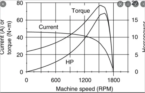

That's kind of the direction I was heading but rather blindly. So as a start, if I get my existing motor specs, 1/3 HP & 3500 fixed RPM (or whatever it is). Then what. I want to keep the belt in fixed mid sheave combination lets say. But in dummy terms, if the RPM knob goes from 0-100% (0=off, 100 = max rpm) and I set knob to 25% for slow RPM, is there something like a motor curve that shows (guessing here) maximum torque at corresponding RPM so I can compare to my fixed rpm motor qualitatively?

Ah! where did you get that data from? I didn't see any spec sheets in the motor web link.
There is a PDF download with technical info
Note on motors.
There are 3 main classes we look at when considering VFDs
Inverter Only motors... usually the best 1000:1 speed ratios are common (moderately expensive)
Inverter Duty a compromise that is usually not too bad, 15:1 speed ratios are common. (usually most expensive)
Inverter Ready, basically a POS when it comes to variable speed applications due to terrible 2:1 speed ratio. (cheap)
Use the sites filtering under "Inverter rating"

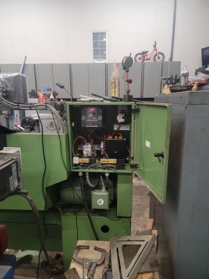

Agree. There are few things a cabinet should do for you. Paramount imo, especially in a machine shop with chips flying, is to stop something shorting across the terminals. To do it properly (to code) ventilation would be through a screen and filter....can't have any openings where a chip would get in. Actually, to do it properly, you buy a cabinet, rated etc...not supposed to make them yourself, they need the sticker :rolleyes:.
Have you had over heating problems with a VFD? We put a lot of VFD's in cabinets, can't remember what the ventilation situation typically is...I'll ask the electrician.
Hacker
My L510 will overheat after a few hours if i keep the cabinet door shut. I need to add ventilation and a fan.
That is interesting. What is the size of your cabinet? I have mine mounted in a repurposed fire alarm cabinet with ventilation holes in the bottom and top and have never had any issues with heating. I use the same cabinet for my RPC controls.
Darren
