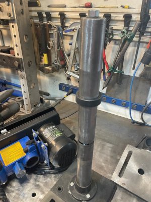

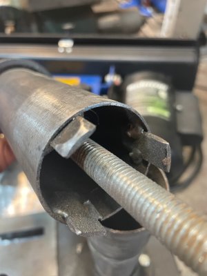

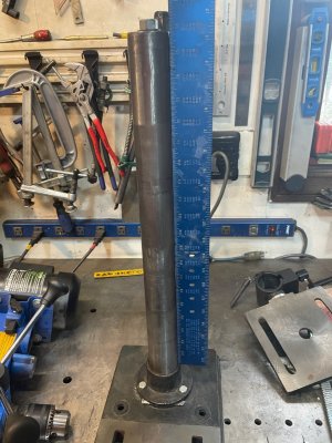

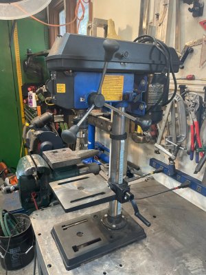

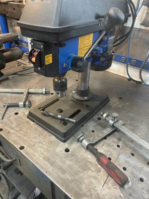

A while ago I thought about getting a mag drill - three things held me back. 1st -the price; 2nd - my fab table has a stainless steel top: and 3rd the price.
This Vevor rather does away with 1 & 3.
To resolve #3 (the SS issue), I made a custom drill that replaced my need for a mag drill.
I shortened an inexpensive bench drill press (Crappy Tire). I have to clamp it to the object being drilled instead of activating a simple magnet. The mag drill won't stick to my SS top and that's where I wanted to drill a pattern of 5/8" holes for clamping on the fab table. It takes about 15 minutes to reconfigure the drill back to its original design/purpose.
Here’s a couple of pics of it shortened:

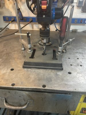

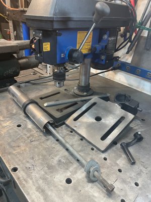

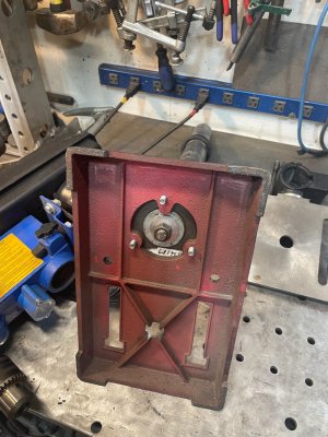

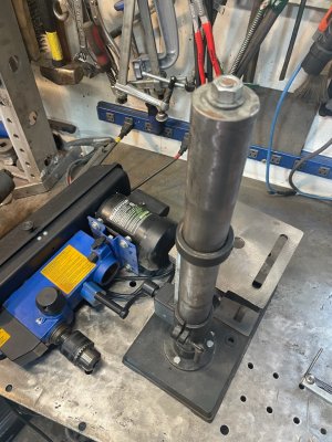

Here are some pics of its pieces and the sequence to reassembling it:

It goes back together pretty straight as this pic shows. Also here is it fully assembled.
