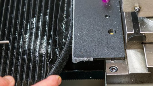

To make the lathe a little more user friendly here are some photo's of a couple of accessories.
Please note:
1. That the parts except for the stretchable accordion apron used are my designs, done in Fusion 360 and 3D printed with a Bambu Lab X1C 3D Printer.
2. I try to keep my tolerances when 3D printing in the .01mm ( 4 tho) range.
3. No holes were drilled or tapped in the lathe or drip tray.
4. No back splash guard comes with this machine

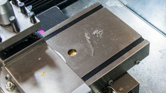

A) Cross Side:
To eliminate the chips etc getting into the "T" shaped tracks. I made 2 slide in attachments.
B) Ways and gearhead drain plug:
This is sort of a combination unit that solves the problem of :
i) the drain plug which is in the back corner basically over the inside way with really no means of not getting oil over everything when changing / draining oil from the gearhead
ii) preventing clips etc from getting into the ways

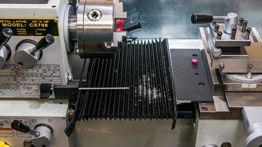

iii) preventing the stretchable accordion apron from billowing up into the chuck when the the carriage is moved closer to the gearhead

Photo 1: "T" shaped cross slide inserts

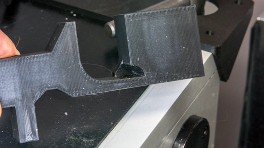

Photo 2: End view of "T" shaped inserts. The other end is half mooned as can be see in Photo 3
Photo 3: Spacer plate that has Velcro attached to hold the accordion apron with clips in the folds

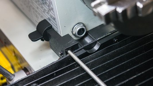

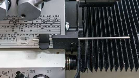

Photo 4: Showing the apron and the sliding apron rod

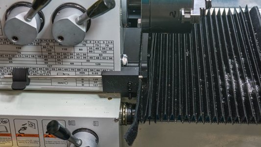

Photo 5: the sliding apron rod, thumb grip on the rod which has a 3mm setting bolt on the underside along with a 3mm brass insert

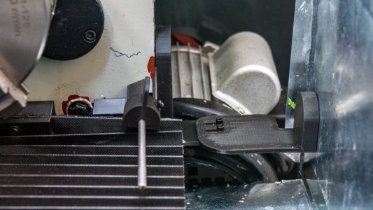

Photo 6: the sliding apron rod slide back

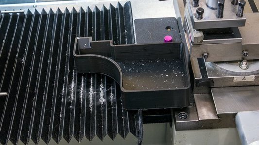

Photo 7: the rear sliding apron rod which can be set as a bumper so as not to allow the tool post bit to strike the chuck, the gearhead drain plug nut and the removable oil pan with Sharpies
Photo 8: Oil pan
