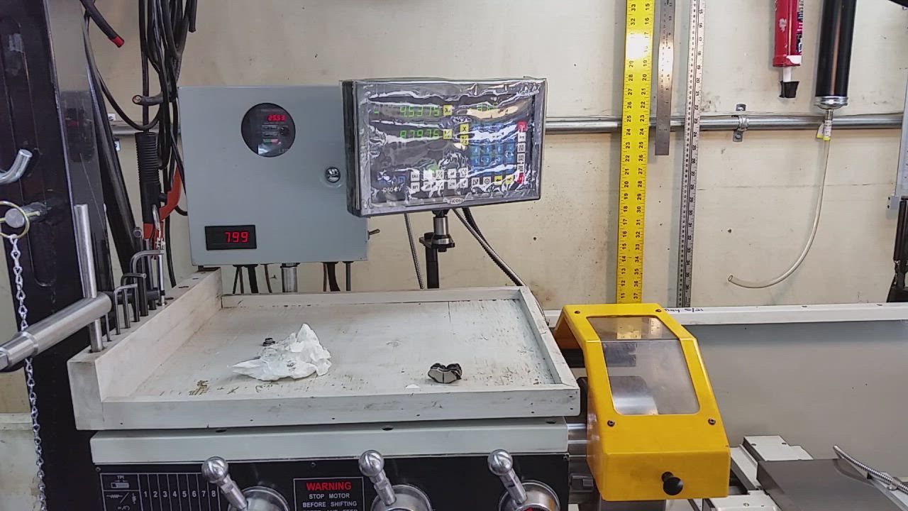

If any one is curious about the LCD and custom control panel I made. I will post more info.
It was my take on the LCD / e stop, speed POT, and inch button.

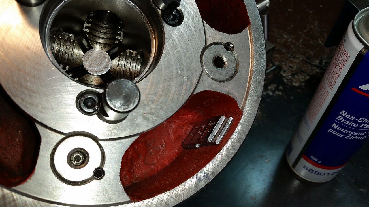

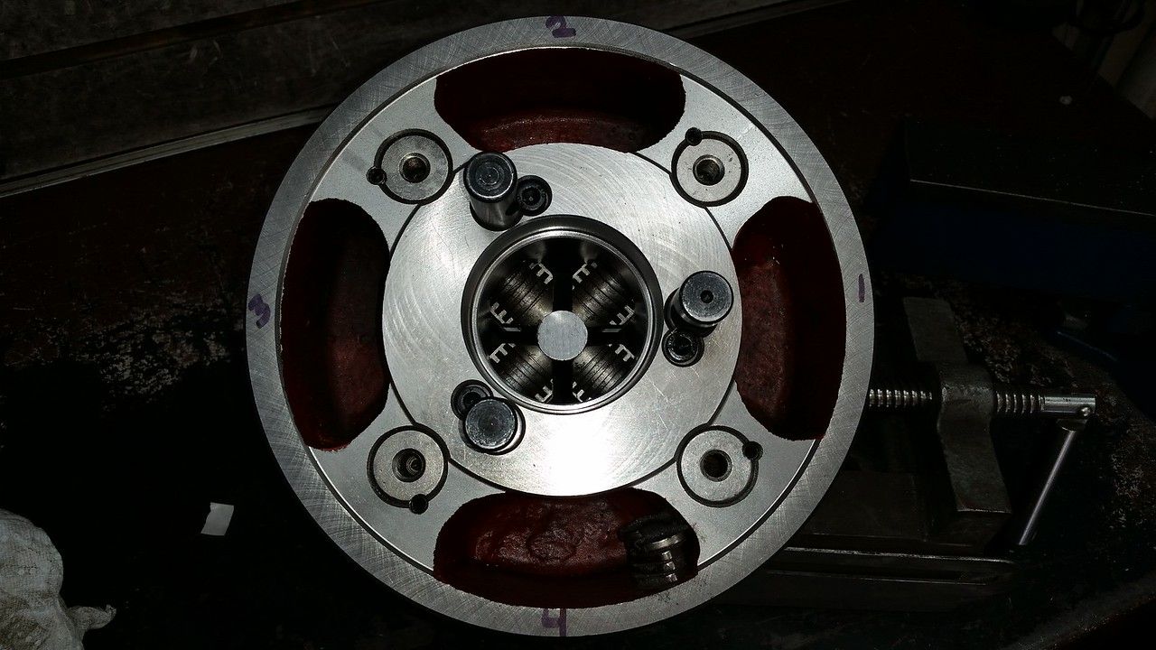

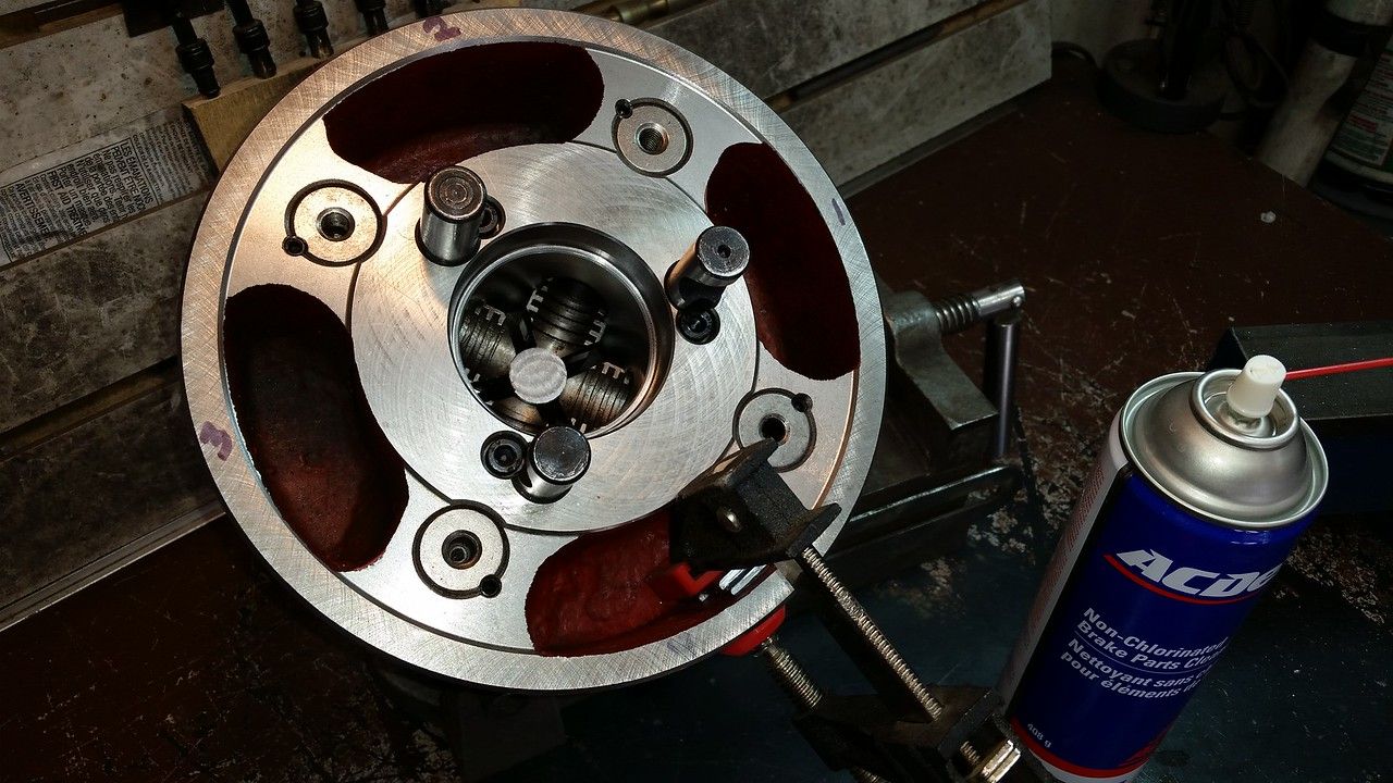

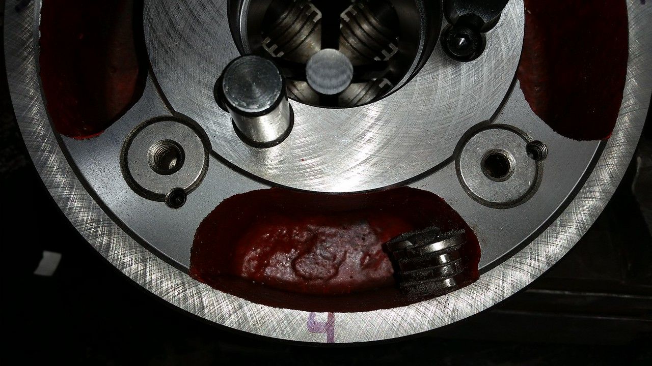

Picture of the backside of the chuck, The pocket was terribly over cast and spent a ton of time die grinding and then fine tuned the last 5 grams with holes,

I divided my chuck into 4 equal sections, I then moved a magnet of unknown weight every 10 or 15 degrees around the chuck body and spinning the chuck up to around 600 rpm, Once I found the spot that made it better I would then mark the extremes where the chuck was better then progressively worse, So now we know our area of interest.
Then its just trial and error with more and more weight, Until you have little or no vibrations according to the dial indicator or DTI.
In my case it was 81 grams, and meant that opposite of the weights was the heavy spot. Confirmed with the ugly over cast pockets ( a blind man could see the discrepancy )

Thanks for posting this, I have not used my 4 jaw much and never really noticed any vibration when I did. After watching your video I mounted my 4 jaw and checked for vibration all the way from 10 to 2000 spindle rpm. I found that there was a pronounced vibration that started about 775 rpm and went away about 830rpm. When I checked the 4 cavities on the back of the chuck I noticed that 1 of them is about .100 deeper than the others. I have a bunch of small magnets from some hard drives I scrapped so I used the same method you described for balancing and found that 49 grams placed at 1 end of the deep cavity reduced the vibration to a negligible amount. I then used 7 seven gram stick on wheel weights in place of the magnets for a permanent fix. I did a small video where you can see the level of vibration by watching the DRO display, there is a short pause in the middle where the stack of magnets disappears off the top of the lathe and magically makes it's way into the back of the chuck to show before and after. Click on the last picture to link to the video.

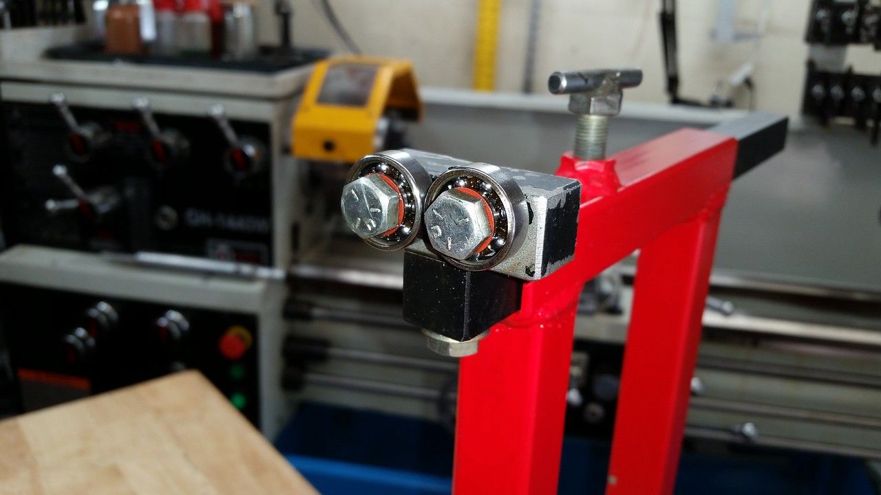

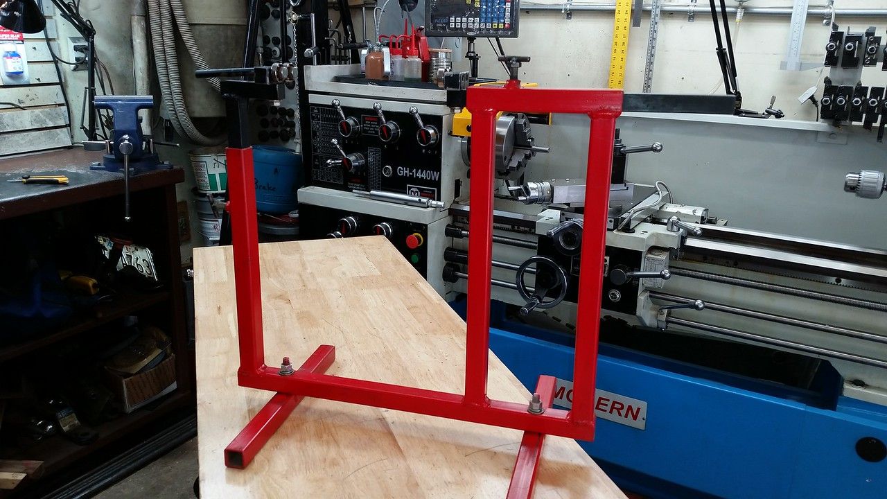

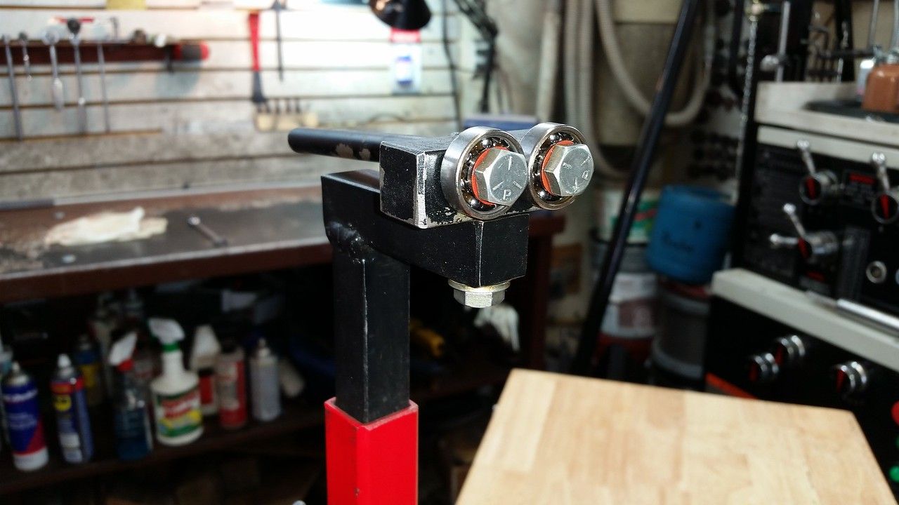

As Peter suggested, I checked the static balance of my 4 jaw on the motorcycle balancer I built many years ago. I removed the weights I had installed earlier to see how it would react on the static balancer. The 49 grams or 1.75oz of imbalance are very obvious and it wound up using exactly the same amount of weight in exactly the same place to off set the chuck's imbalance. You can see how obvious it is in the short video.
https://johnconroy.smugmug.com/GH1440W-Lathe/n-QdB9WL/i-F58kzdV/A
Well that was pretty gratifying to watch. A 3-jaw scroll would be easier yet because it grips the bar just by tightening, no DTI really involved. And once you have it dialed in should never really vary because jaws are extending equally. I have some spare ~15mm OD matched bearings kicking around, I think I'm going to make me a balancer tool.

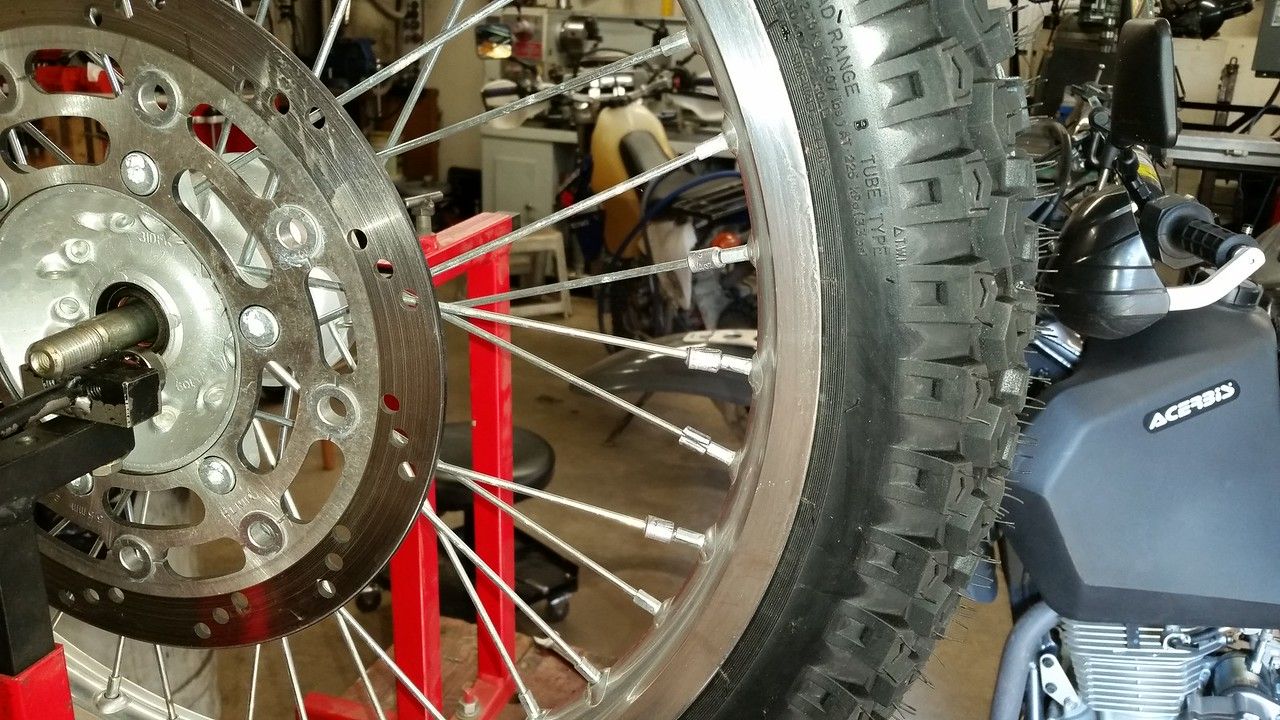

When I built my balancer I used some 8mm ID X 22mm OD bearings and removed the rubber seals. Each time I use it I flush any dust out of the bearings with WD40 and follow with a drop of 10wt spindle oil to reduce rolling friction as much as possible. The accuracy for static balance is very good, 3 grams (1/8 oz) is an obvious heavy spot on an 18" motorcycle wheel. Something as small in diameter as an 8" chuck you need about 7 grams of imbalance to be really obvious.
The right side is adjustable for width and the left for height. Quite often motorcycle axles are different diameters from one end to the other.
So the hex bolts are clamping the inner race to the block & the outer race is free to spin, is that it? Is there a offset spacer washer on the back side of the inner race?
That's right, you can just see a bit of the red 8mm ID X 10 mm OD fiber washer under the head of the 5/16" hex head cap screw. There is another one on the back side of the bearing that allows clearance for the outer race to turn and not rub on the block. The OD of the outer races of the 2 bearings are spaced 1mm apart.
