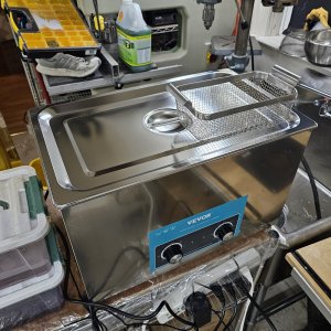

Second one shows the basket from other cleaner, this thing is huge! I have it on a wheeled cart which is the perfect height to drain it. It would be almost to much carry it over to the sink and drain like the smaller one so this should work well. Need to find a shelf for it between uses.

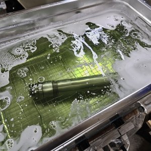

Overall pleased. Lid and tank are light gauge so the tank probably is as well, but hey it was 200 not 1200 and it's only going to see occasional home shop use. Cleaning action seems aggressive. Last photo shows a spindle with room spare - so far so good!

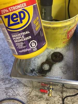

Ok, I thought I should put the ultrasonic cleaner through its paces before I break down the cardboard box.
It's so big I had to put a bucket in it to bring up the level of the cleaning solution, I dumped in a gallon of Zep industrial cleaner, their masonry cleaner and heavy duty degreaser are all the same stuff, Lye or sodium hydroxide.
I had to take it outside the garage because of the fumes.

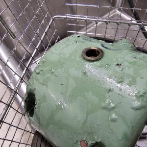

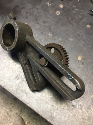

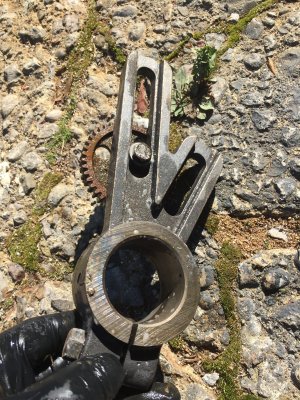

The test piece is from a Logan lathe, hasn't been cleaned in 70yrs, with the heat on full I let it cook for an hour, probably could have pulled it out in half that time.
The solution only came half the way up the piece but there was no definitive clean line because the vapors melted the rest of the grease off, I was impressed.

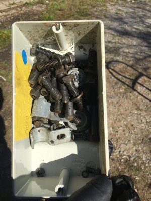

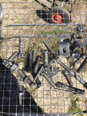

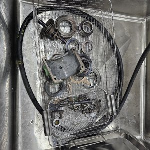

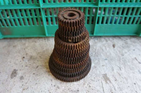

While the solution was still hot I threw in a handful of greasy rusty fasteners, half an hour later they are clean, the little bit of rust that was left on them came off immediately on the wire wheel.

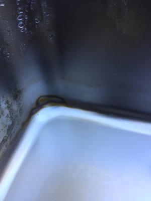

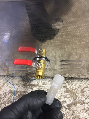

I emptied the reservoir of the lye cleaner, you can see heat marks where the heat element is touching the SS tub, I will open it up and see if I can reposition the element.

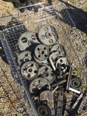

Next I thew in a couple of gallons of citric acid and salt solution that I made up this morning, it doesn't work very quickly when the water is cold, the change gears were soaking in it for a few hrs before I dumped it into the ultra sonic bath,
Half an hour lather I rinsed them off, even more impressed.
Things I don't like, the lid is just a little thicker than tinfoil, the plastic hose adapter is garbage, just throw it away.

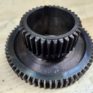

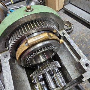

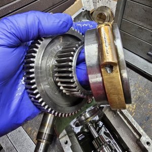

Seeing as how clever a fellow Dan is, I tried the pinesol. Fairly light concentration, 1/2 bottle into the 30l tank. Ran it heated for about 1/2 an hour. It did a great job, but it also stained the parts.
Here's a shot while disassembling the HS, everything nice and bright
and the parts after cleaning .... a new bluing formula!
It also took the paint off - while ultrasonic cleaning will that, it seem aggressive because of the pinesol.
No harm no foul as the bluing won't matter for internal parts and the HS is getting painted anyway, but if using Pinesol be aware of this.
It is so nice having a tank this big. Fits a whole spindle or HS!
