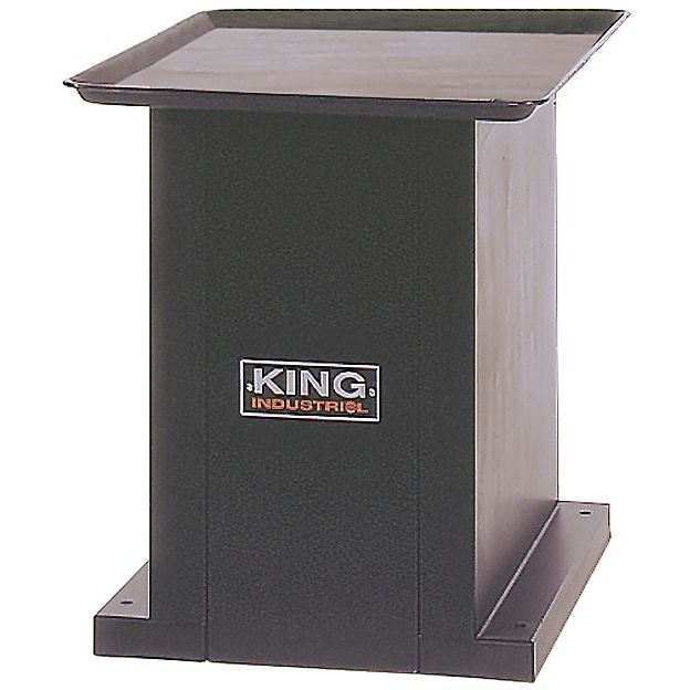

@David_R8 's stand is about the same speed. He indicated to me the bottom of the legs are 27" W X 24" D. @thriller007 what does that stand measure that you got with my machine?
trlvn
King Canada's PDM-30 mill/drill is in the same class, so I checked the stand they offer for it (SS-45):
L X W X H -- 31 X 21-1/2 X 28-1/4
That makes it a skitch more narrow than mine. I do note that it has the provision to be bolted down to the floor. Nonetheless, I think mine (31-3/4 X 22-1/4 X 30-1/4) is in a reasonable ball park.
BTW, I'm not sure the Busybee stand is really comparable since they don't sell an RF-30 type machine any more. I think their stand is intended for the smaller RF-45 class mini mill.
