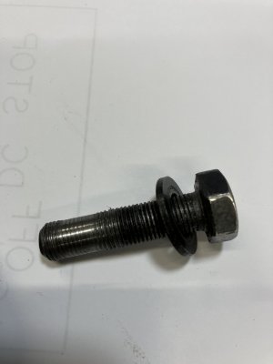

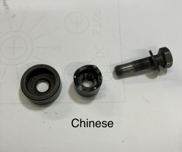

Greenlee chassis punch. I usually cut holes in sheet metal using a step bit, but had a bunch of 1/2" NPT (22mm) holes to do for the electrical panel on my new bandsaw. Decided to buy a single 1/2" knockout punch from Amazon. Absolute piece of crap. The 3/8"-24 UNF thread on the punch is cut way oversize, so the pull up bolt strips after two holes. Thought it might just be the Chinesium bolts, so tried a nice F593 304 bolt I had in stock. Same result, stripped on the second hole. Not one to give up easy, next attempt using a Grade 8 bolt. It lasted three holes.
Enough of this crap, went and found a real set of Greenlee punches. No idea how old they are, but they're in a leather pouch. I know the set at my old business is in a green plastic tray, and it's at least 25 years old, so I'm guessing the leather-wrapped set could be old enough to have voted for Joe Clark.
First try with the Greenlee demonstrated to me why I should have bought them instead of trying to save some money.
Look at the points on the Amazon punch. Four holes in 18ga steel, eight holes in 0.030" aluminum. Dull. Compare to the points on the Greenlee. No idea how many holes done by the Greenlee, but the points are still sharp.
Amazon $20 for a single cutter, Greenlee $40 for the set.

@whydontu What do you think is wrong with the chinese ones? Clearances & fit? Hardness? Sharpness? something else?
Right off the bat the female thread on the die is way too big, maybe only 25% depth of thread. The die is probably hardened, but likely not too well. It kind of smooshes its’ way through the metal.
To get a decent cut, I had to use a socket and 1/2” breaker bar with the Chinese cutter, and put some heavy-duty torque into it to get it through 0.030” aluminum. The Greenlee has a small square head bolt, and I could get it to cut nicely in the same material using just a 7/16” open-end wrench.
Clearance between punch and die seems tighter on the Greenlee.
Cutting edges on the Greenlee are visibly sharper, but of course I didn’t take pictures of the Chinese one before I used it. I suspect they were crap edges from new, like @jcdammeyer s countersink bits.
I was introduced to greenlee punches about 45 years ago. They are amazing. They shear the sheet metal in the conventional way but do so progressively. The points cut first against a very firm anvil and then as the metal shears away, adjacent edges take up the slack shearing along till the full circumference is sheared.
To do the job easily, the angles, edges, and anvil must all be perfect. The device I saw in the first photos tries to shear too much at once instead of progressively. Thus the forces required to do so skyrocket and the result is...... As noted.
Everyone who cuts holes in sheet metal should have a set of greenlee punches. Or at least a few of the standard sizes.
