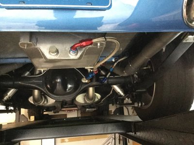

In my early days of drag racing, I was trying to use the stock gas tank. Half track the car would go lean and in some cases stall.
The sump on the stock gas tank is in the middle, so as soon as you create any serious g-force all the fuel is at the back half of the tank. Sort of worked with a really full tank except the fuel would spurt out the filler spout and not ideal to accelerate 100lbs of fuel (every 100lbs is 0.1s).
Solution replaced the tank with a fuel cell with sump at back. Works great even with just one gallon.
Now good to 1000' then lean again.

Good looking welds! Did you weld up the tank yourself?
