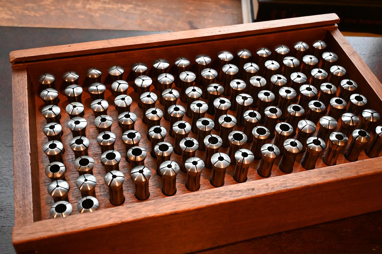

Tiny Drill chuck
just pop down to the Hasty Mart and grab a set of these :D
My stash is presently rather more modest. But July is birthday month, and I have committed to building a clock (in tandem is with a very good friend) starting later this month. Progress on that should release some funds from the CFO. No bargains on eBay unfortunately.
I really need to start selling my stash of Univac hw from the 1950/60's, core memory should raise a good pool as well.
gerrit
those are 10mm Derbyshire's. There is embarrassing large piles of 8mm, 12mm 20mm 5c 2J......it is a disease.
Its a very long wait for a complete set, great brand, great condition and low price. Despite how cheap I am and always prowling for a bargoon....collets are one area where you sometimes just have to pay up.

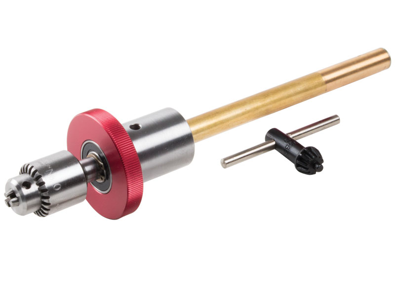

This is why I suggested the Albrecht/Sherline/Indian sensitive feed mechanism. Holding the drill bit is not that difficult as many here have shown, it's the issue of having sufficient feel to not break tiny bits that is a greater problem IMO. The quill down feed on a mill or mill/drill is fine for larger bits but a bit heavy-handed for tiny bits.
Like most things the expense is proportional to the quality ($40 for new sans-chuck from India, $175 for new Sherline, and $250 - $400 for used Albrecht).

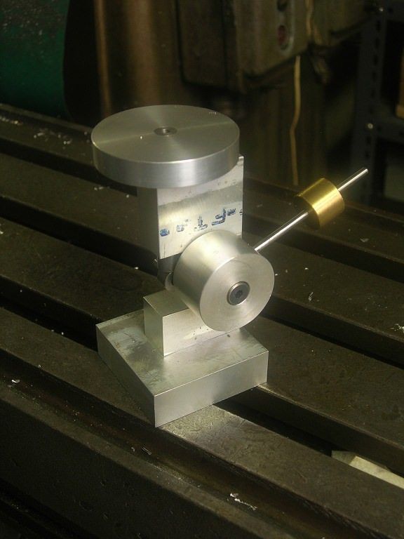

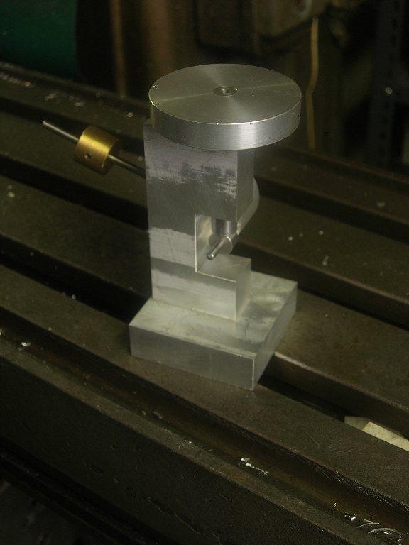

..The best sensitive drilling device I've seen is this one, the design of which appeared in Home Shop Machinist eons ago. The lever pivots on a shoulder bolt; other than that everything is visible and one could probably be built from the photos. I can't remember the designer name buts its better than any other sensitive drilling design I've seen. Build it with a thou clearance so it feels frictionless, set the brass counter balance and you can advance the work up into a rotating drill and about the only force you feel or have to overcome is the drilling op. A piece of masking usually suffices as a hold down.
That is a great little tool. As you know many of the small sensitive drill presses have lever-operated tables and fixed quills (opposite to the standard drill press where the quill moves vertically and the table/workpiece remains stationary). Making a little moving-table platform for use in a more common machine is brilliant ... and is now another thing for me to make :)
Thanks for posting.
Dave

What I would like to have is something that will work on both a lathe AND on a mill. The lathe device is easier to do because the chuck doesn't spin, but in both cases, the collar only provides thrust so the mill device should work on the lathe but not vice-versa. Am I missing something?
I also like @Mcgyver 's little lift table. Who cares if it is the quill lowering the bit or the table raising the part. A sensitive table is just as good as a sensitive chuck holder. And I really don't think the part needs to be held in a vise when any of us could snap the drill with torque from our hands without even thinking about it.

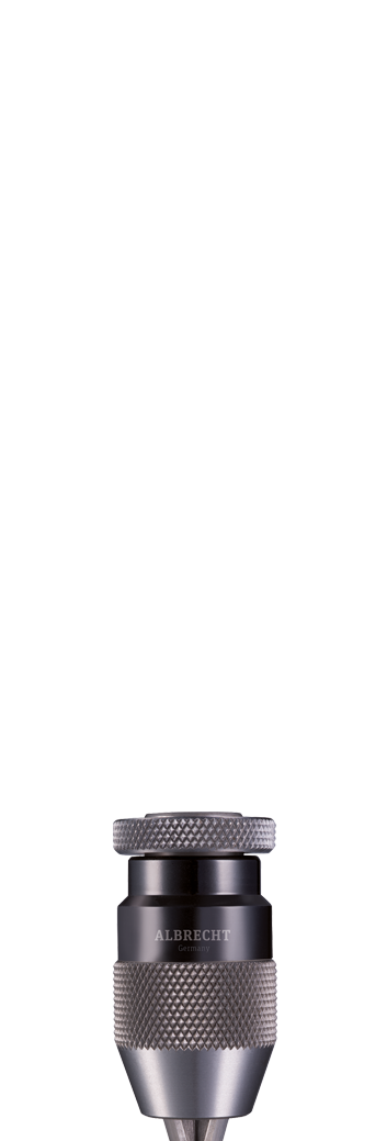

So getting back to chucking pin vises which then hold a small drill, everything I see has a knurled or some kind of 'gription' surface intended for manual holding. This is the reason why I'm skeptical that holding it in a chuck didn't look like reliable way to achieve low runout. Unless maybe a 4J & dialing it in.
I thought maybe like these but the description infers just another form of handle.
Are there other products out there intended to be used this way?

Hi McG: I have a set of these, but they were badly stored in wood with humidity. They hurt my feelings for appearance, but have never failed me. I would like to find a shiny set. If you ever come across another set, please give me a heads up. I have a very nice BB Derby with a quick release collet holder, lever tailstock, cross slide, QCTP of my own making and lots of misc. collets. But the main set is corroded, sigh. Regards, Ian Moss
Hi Ian,
That's a shame about the corrosion. Its not affecting the ID's or taper section? If not, maybe they'd polish up?
Serendipity will bring you set, how I got these...mentioned it enough and a friend of a friend was found.
...but it was a long wait, took years . Its for a Levin 10mm - list price of the set new is like 30,000 CDN. metric from .1 to 8 and imperial by 64th's. I guess if you are making some super expensive medical or aerospace device its no big deal but it means its not doable for home shop guys. I couldn't stomach the cash outlay even for used prices and I ended up trading a reconditioned (by me) older Schuablin 70 (sweat equity collets). The two are of about equal value, although I've been working for around $0.25/hour finishing the Schaublin. Most of my shop has been put together slowly for small dollars but with items like that set that rare and pristine imo you have to pounce when you see it.
If I see another set I'll let you know.
The cost of the Sherline is $120 US but it includes a chuck. I cant figure out if this will fit an R8 spindle using a larger chuck or a collet, and I can't figure out if it will fit an MT3 lathe tailstock with a suitable drill chuck or collet either. It seems to be purpose made for a Sherline mill with a screw on spindle nose.

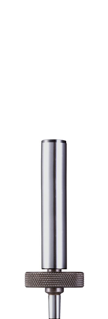

Here is the Sierra American Accu drill. It looks like it can be chucked in a half inch drill chuck or a half inch Collet. It is $105 Cdn at KBC but does not include a chuck.

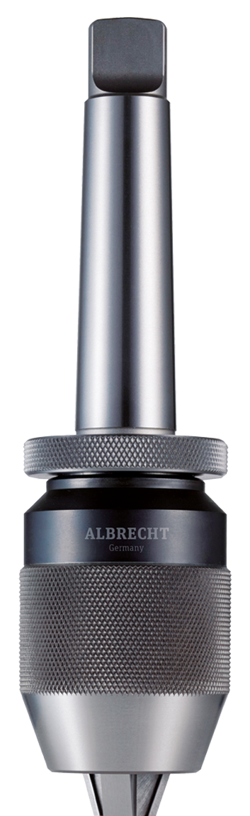

The Albrecht looks like it comes in an R8 with a chuck or a straight shank without a chuck, but it isn't totally clear to me what is what. The chuck is only spec'd down to 1mm which would not be small enough for my needs. I think it might be necessary to contact them. I could not find pricing.
I found several products that might be described as the Indian version.
The first is available from amazon for $105 but looks like it only works on an mt3 lathe tailstock.
The second looks like the Accu drill but comes from India with a chuck that goes down to 0.3mm. Looks like you could get a better MT0 chuck for it if you want. It is $60 (plus shipping) on amazon with the chuck.
Here is the same unit without the chuck for $36 plus shipping on amazon.
The third was REALLY INTERESTING!!! It appears to be a little machine shop product made in the USA being sold in India for 26579 Rupees!!! Converting from Rupees to Cdn, it was $450 assuming I did it right.
I also found this last one on little machine shop too for $142US. Looks like they get shafted in India even more than we do! This is a tough one to figure out......
The Albrecht sensitive feed does come in a straight-shank version that could be held in a collet (that's what I do with my Indian version) :
They also used to spec their chucks down to 0 but now I see 0.2mm is as small as they claim on their "first chuck" (what I am familiar with) :
And you don't want to find pricing :) .... https://www.mscdirect.com/product/details/08591091
