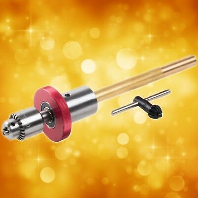

Perhaps a small Albrecht chuck, ideally with a sensitive drill arbor. They can hold tiny bits and the sensitive drill arbor makes breaking tiny bits a little more difficult. Something like this :
The drill feed is by hand, holding the larger black knurled knob that is on bearings. The shank would be chucked on the RF30 with it's quill locked.

lol ... ya, Albrecht chucks ain't cheap but I love them. Bought one a few years back and now have 4 :) I get used ones that have reasonable looking jaws off eBay, then rebuild them (takes an hour or two).

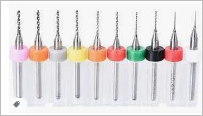

I use these circuit board drills because the shanks are wider & consistent thus can use my accurate chuck or collet. They are carbide, so you need to treat them as such. You can get precision chucks in 0-X size so they can grip pretty small drill sizes, but good ones cost money.

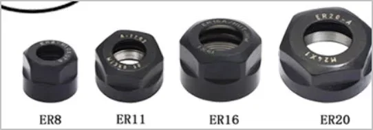

x 2 on using a collet. ER style are particularly useful for small drills. A 1mm collet will easily hold a 0.5mm drill.

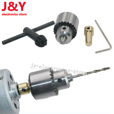

Well, not being one that likes to wait around for things to arrive, and not wanting to part with large chunks of coin, this is what I came up with:
I had a Dremel with a bad motor. I was hanging on to it to fix it one day, but since then I have come upon two others. So I cut the end of the shaft off. The small chuck fit nicely in my larger chuck and I used the fine down feed on the quill and went VERY slowly though the body of the cannon. It actually worked very well! I did have less that 1/4" to go through and the material is (of course) brass.
The drill bit is a #56.

This chuck is from the used Dremel I bought. I really should clean it up and re-knurl it.
I've pondered buying an ER-8 collet system because my so called mini precision chuck is not so precision. But even ER-8 only goes down to 1mm (0.039"). The nut body is 10mm (0.394") which is nice & small but rather cylindrical shaped vs typical drill chuck tapered body & extended jaws. I guess it depends on the job if no tight spaces are involved. I would think a good quality ER would hold better runout than my chuck.

ER8 is perfect. Then just mount that in your ER32 or ER40 tool holder. For a HSS drill runout won't be an issue.
runout on a .5mm drill will most certainly be an issue if you don't want a tapered hole. As well, ultra precision collets are likey outside of the hobby scope price-wise.
For tiny drills I would now use WW collets, having been recently introduced to them. They come in .1mm increments.
