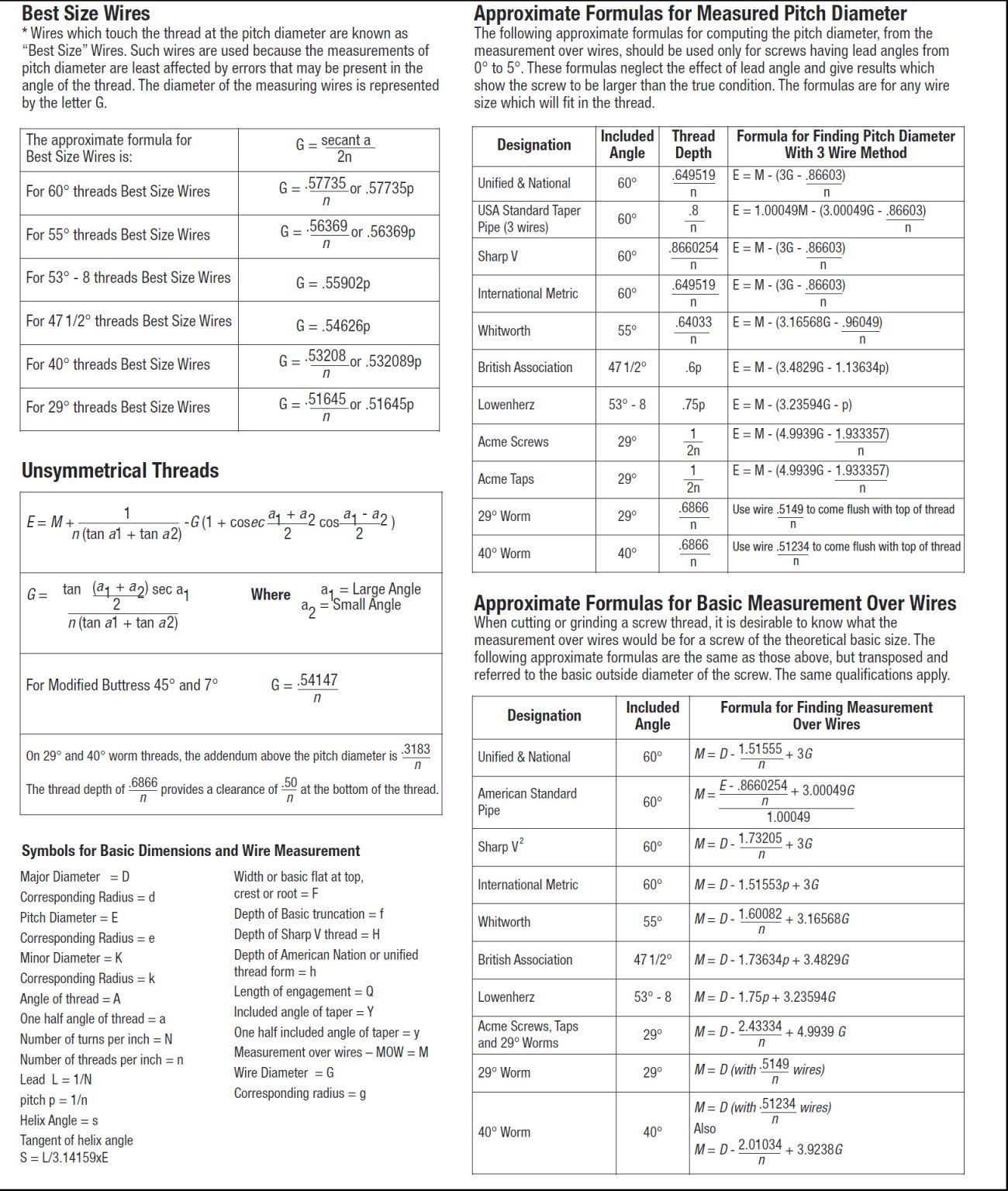

Accusize Industrial Tools 0-1'' by 0.001'' Screw Thread Micrometer with 5 Anvil in Fitted Box, S916-C750 https://www.amazon.ca/dp/B0189RHDWS/ref=cm_sw_r_apan_i_KY35B39PGXBA8QFZP8G7?_encoding=UTF8&psc=1
Turns out that's what I have. But I got mine in a two micrometer set about 5 years ago - maybe more..... Mine are also only 1 thou mics. But that's plenty for the threading I do.
I have multiple ones. They are not that expensive used, usually same price a regular mic is - and used mics are cheap.
As for his threading wire advice, he can go fly a kite. Those things are a fiasco and I hate them. Give me a good threading Micrometer all day every day. Well worth the investment. And just skip right over those dumb wires and all the fancy gizmos out there to hold them. All junk in my humble opinion.
Over the years I've been fortunate to collect thread mics up to 4", all like new mitutoyos....fancy stuff and they are handy.
But I wouldn't be without thread wires. 1) they're only a few dollars until you luck out and trip over a pile of Mit thread mics, but 2), and most importantly you can use them to measure any thread. I've used them for acme, buttress, BA and Whitworth - they save the day over and over. Armed with the formulas below you can measure about any thread
Handling them can be a pain, but you can use a bit of plastercine, inner tube with a slit or grease. All work....and I just happen to have some pics!
